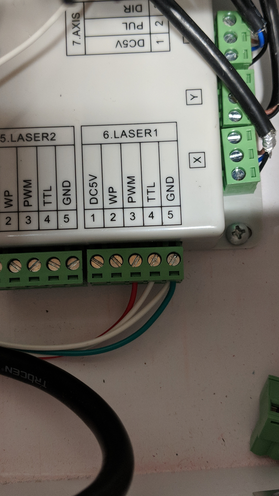

Have this PSU https://www.flickr.com/photos/124204237@N03/33185503360 in my K40. With the upgrade, the AWC708C PWM goes to IN, TTL goes to L all the way on the right of the image. I will test the TTL voltage this afternoon but no matter what power percentage I use, it reports firing over 15mA on the display from the kit and it always burns the wood the same. Even if I use 1%, 0.1% I get the same affect.
I can only change the level of burn by changing the speed which results in a lower quality burn which still burns too much. Anyone have an idea or run into this during their upgrade?

Not quite sure how you connect the "TTL". I don't know what is the pin to the right most of the image (don't like to guess). You better to check the legend mark underneath. If I am not forgotten, you should connect it to either P+ or P- while the K is for water protection. You need to review the system connection diagram and review your connection. Something must be wrong there

The pin on the most right is marked L. It only has a TTL LO marked 'L' next to the pin. The 'P' is stock already connected to the water protection circuit. The K is the test button connections.

I can see a makingon the PCB board showing “G P L G In 5v”
The “L- “ on the left most (not Right most) is for the laser ground.
So, you shou connect PWM to In, TTL to P, and use K for water protection. You don’t need to use K for fire test if you have our controller because you can do fire test on the keypad

The L- (Laser Cathode) is on the most left and just plain L is on the most right. P G came connected to the water protection device when I bought it and works as advertised.
I moved TTL to K- and same result but here is where I win "Idiot of the year award".
All this work of being careful making sure connections went to the right location according to the lightobject connection diagram, I put the LASER1 phoenix connector where LASER2 is (obviously no second laser). So I was only changing LASER1 settings and getting no where since LASER2 was firing at the same default power.
Thanks for your time Tech_Marco and hope others learn from my mistake..

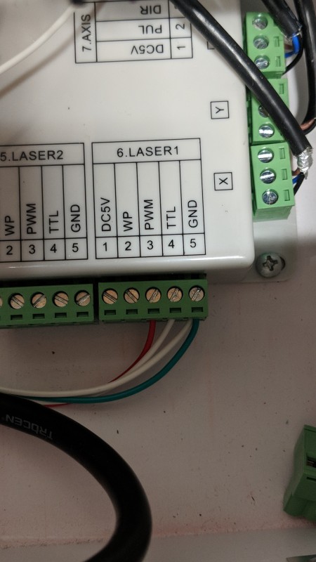

EDIT: I had the motor set to 0.5 A I lowered it to 0.3A and I'll see what happens. Still no luck test firing with the control panel. Ive attached a pic of my DSP where it plugs in.
The green and white wires on the ground plug both go to the two spots labeled ground on the power source.
The White wire in the TTL spot goes to the P on the power source and the PWM green wire goes to the IN port.
I will try connecting both of the ports labeled G on the power supply to the Ground on the DSP and see if that works. I am pressing the Laser button on the control panel with no result. I have also tried pressing the test button on the power source and as long as the DSP is plugged into the power source it doesn't fire using either method. As far as the power I had it set to 20% as "Max Power" and I'm assuming nothing is happening because apiece of paper stuck to the first mirror doesn't even show the slightest sign of burning.
When you say reconfigure what do you mean, make sure I have the max current set to 0.4A. I thought I did but I'll check back and let you know on that one.
