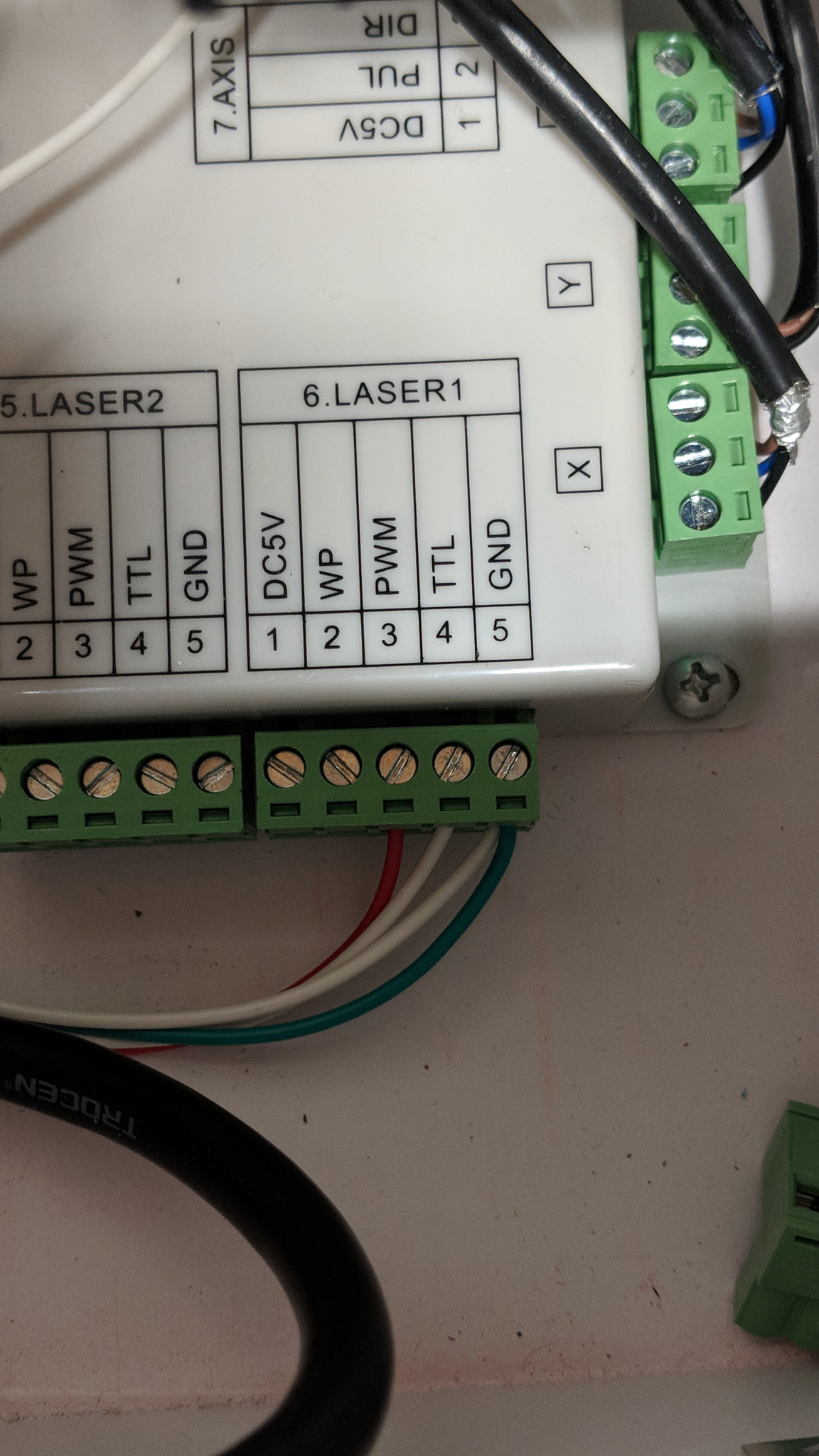

I will try connecting both of the ports labeled G on the power supply to the Ground on the DSP and see if that works. I am pressing the Laser button on the control panel with no result. I have also tried pressing the test button on the power source and as long as the DSP is plugged into the power source it doesn't fire using either method. As far as the power I had it set to 20% as "Max Power" and I'm assuming nothing is happening because apiece of paper stuck to the first mirror doesn't even show the slightest sign of burning.
When you say reconfigure what do you mean, make sure I have the max current set to 0.4A. I thought I did but I'll check back and let you know on that one.
EDIT: I had the motor set to 0.5 A I lowered it to 0.3A and I'll see what happens. Still no luck test firing with the control panel. Ive attached a pic of my DSP where it plugs in.
The green and white wires on the ground plug both go to the two spots labeled ground on the power source.
The White wire in the TTL spot goes to the P on the power source and the PWM green wire goes to the IN port.
