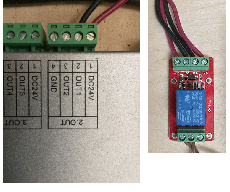

i use the OUT1 on 2.OUT to trigger a relay and start the air assist compressor whenever the table is in motion. that way there's no timing issues between the air starting and the laser firing.
it is very fast, also i just turn the exhaust fan on when powering my cutter. it's quiet and it's better on the machinery to keep it running than subject it to rapid power cycling.
