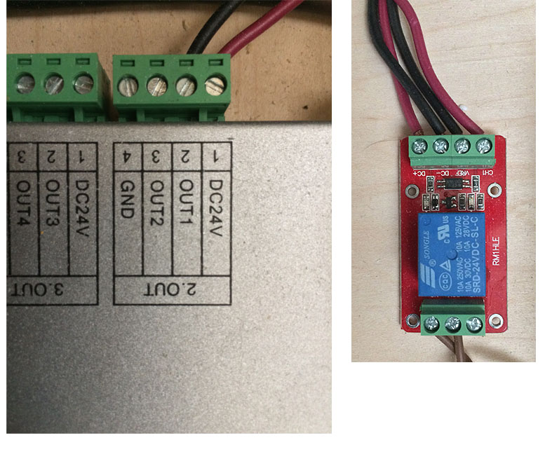

I'm using the OUTPUT1 signal to start the exhaust fan on my laser, but the job starts too quickly for the fan to come up to speed (and the air assist compressor for that matter).
Has anyone used or experimented with the footswitch control input (INPUT2?) I have a microcontroller on my laser that is connected to the fans, the inputs and outputs, etc., so I was about to experiment with the following:
- When you press START, the OUTPUT1 signal goes high.
- The microcontroller will immediately turn on the exhaust fan, _AND_ press and hold the "footswitch" (INPUT2).
- Microcontroller waits for the fan to come up to speed
- Microcontroller releases the footswitch (INPUT2)
- Job runs, eventually it completes (OUTPUT1 goes low)
- Microcontroller runs the exhaust a little longer, then turns it off.
I find that the footswitch is a multi-purpose input. It also *starts* jobs (works like the start button). I will need to experiment some more, but it would certainly (to me, anyway) be a good feature for the AWC to have a programmable delay between OUTPUT1 activating and the actual laser job.
The other option I have is to have the microcontroller start the job using the footswitch control, then I can do all the sequencing there. I'd prefer to use the start button on the AWC's keypad though.

i use the OUT1 on 2.OUT to trigger a relay and start the air assist compressor whenever the table is in motion. that way there's no timing issues between the air starting and the laser firing.
it is very fast, also i just turn the exhaust fan on when powering my cutter. it's quiet and it's better on the machinery to keep it running than subject it to rapid power cycling.
