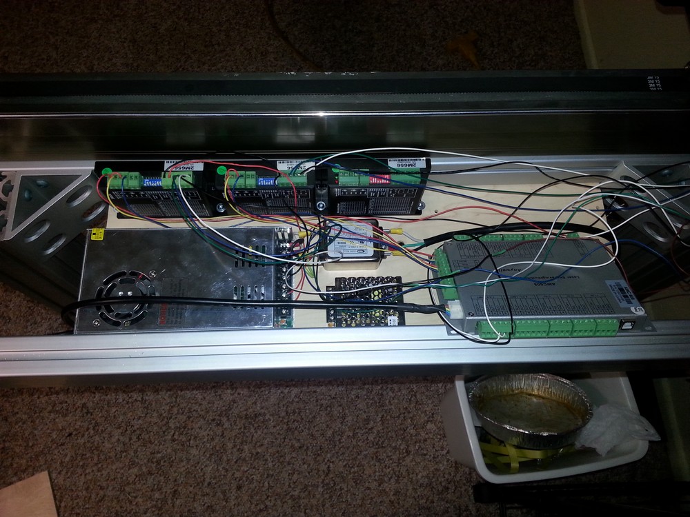

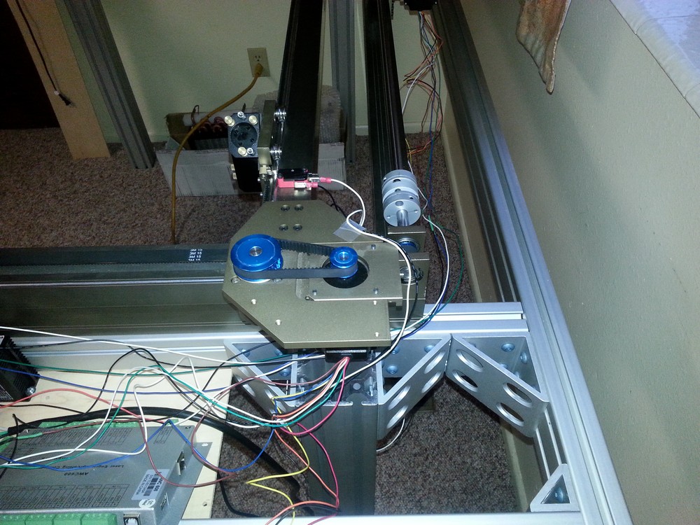

Alright, here are a few pictures.
One thing that I've noticed is that for the X axis, if I press the Right button on the panel, the laser head moves Left, and the Left button moves it to the Right...
I still have the calibration to do, so I'm still looking into that.
The control board
The control board
The laser tube will go behind and above the Y motor
Rear of the frame
Rear of the frame
The electronics.  I still have some fitting to do.
Posts: 4654
Re: Testing stepper motors stage of building troubles
[quote="jarbon"]One thing that I've noticed is that for the X axis, if I press the Right button on the panel, the laser head moves Left, and the Left button moves it to the Right...
quote]
That is a simple problem and can be fixed by using LaserCad to change the direction of the movement. Please review the manual as it is clealy explained so I'm not going to explain again
