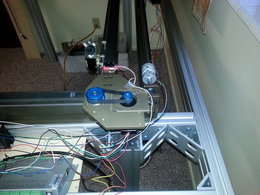

You can control the direction of HOME on LaserCad. Plus, you need to get a proper "um" in order for the motor to move smoothly. What machine are you running? Pictures? I always ask folks to post pictures when there is a problem to setup a machine other than K40

Alright, here are a few pictures.
One thing that I've noticed is that for the X axis, if I press the Right button on the panel, the laser head moves Left, and the Left button moves it to the Right...
I still have the calibration to do, so I'm still looking into that.
