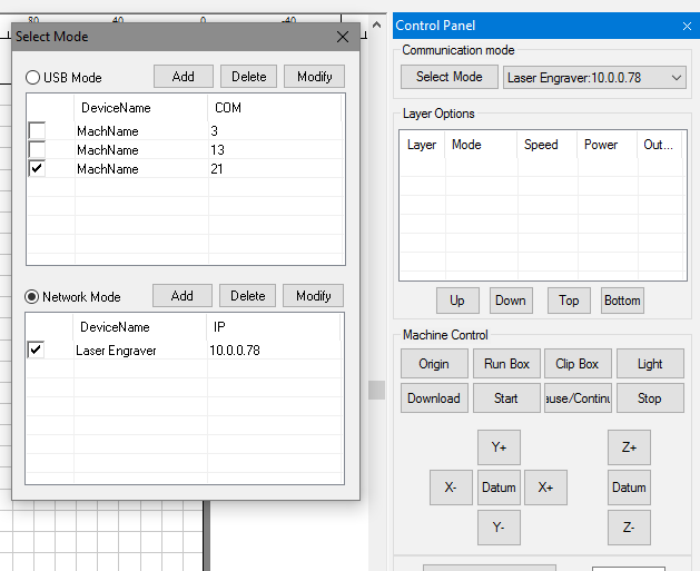

You have to run it through your router. You can't directly connect it to your computer lan connection. Also you will need to set the IP address on the controller to be on your network in the network settings on the controller. Once you have that done in LaserCad go to communication mode on the right side control panel. Click select mode then edit the settings to match the ip address of your machine. Make sure to select network as the communication mode.

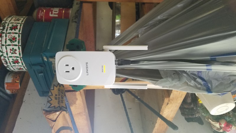

If your router is wireless you don't need a longer cable. Get a wifi extender like the on in the pic. Hook the Controller into the lan connection after you have set it up. It should work just fine. That's how I have it. I can operate it and send files from anywhere at my place.

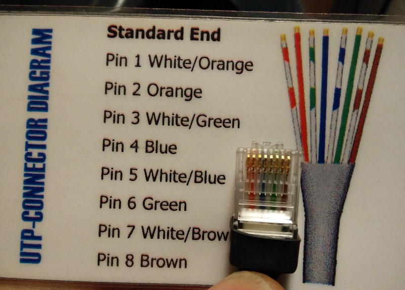

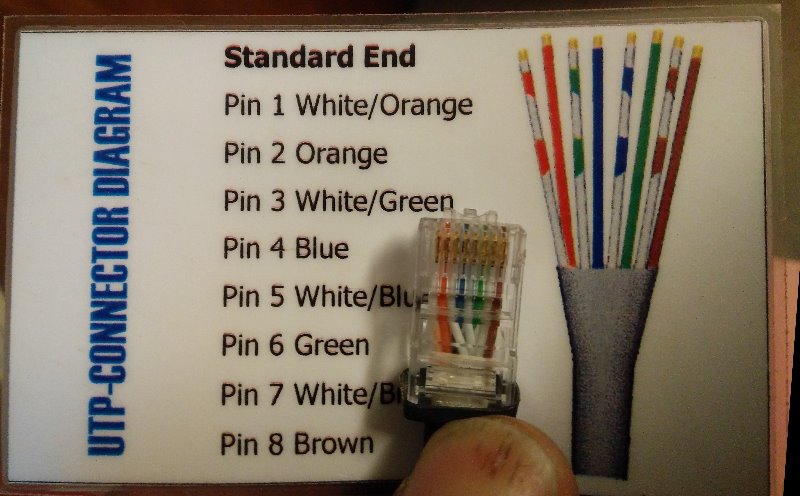

I know how a cross-cable looks like.. But i have a straight cable between my DSP (LO-X7) and my PC:Tech_Marco wrote:I mean direct connection between a DSP to a PC. In that case, we have to use a cross-over cable instead of a standard network cable.
This is my computer end of the cable: And this is the Laser end of it: As you can see: they're both the same...
I don't know why my computer communicates fine with the X7, but it does..
