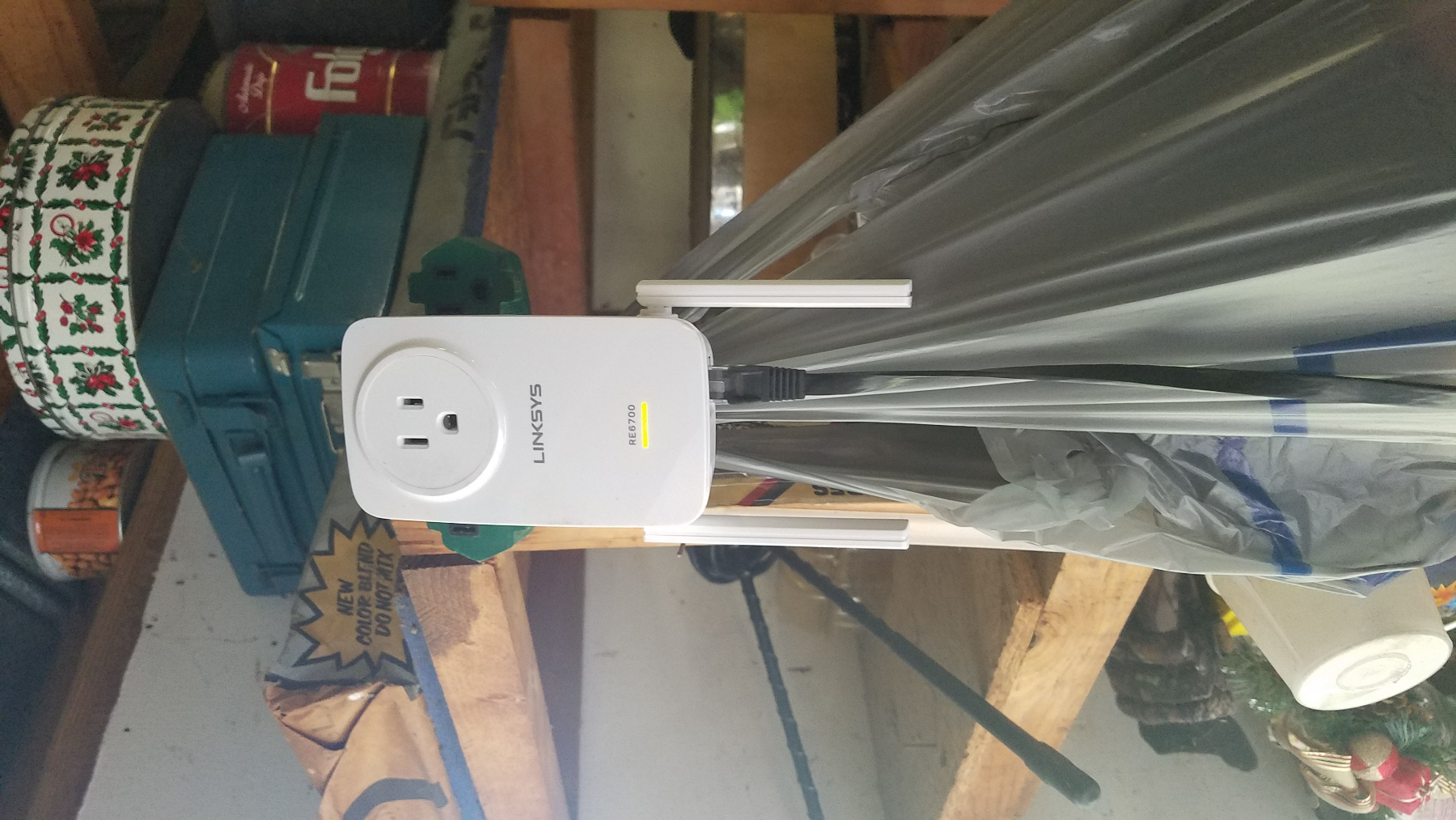

If your router is wireless you don't need a longer cable. Get a wifi extender like the on in the pic. Hook the Controller into the lan connection after you have set it up. It should work just fine. That's how I have it. I can operate it and send files from anywhere at my place.
