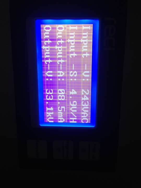

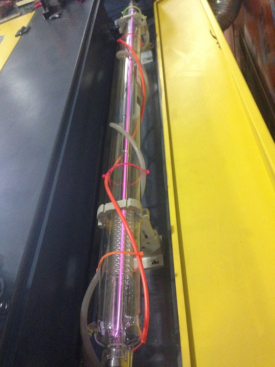

the 5v line is tied to TH, the laser if firing, it is just doing so at a super low amperage. I have added a pic of the tube and the readout of the psu..
