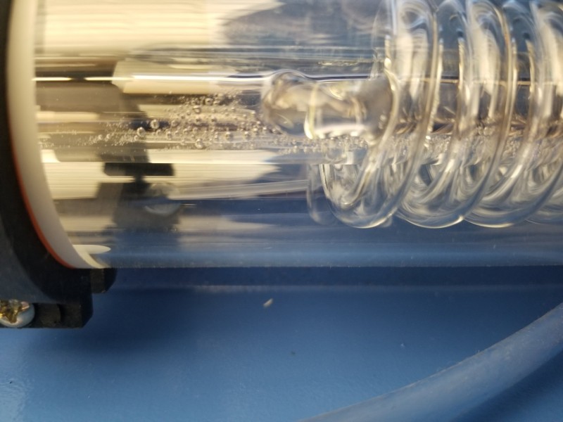

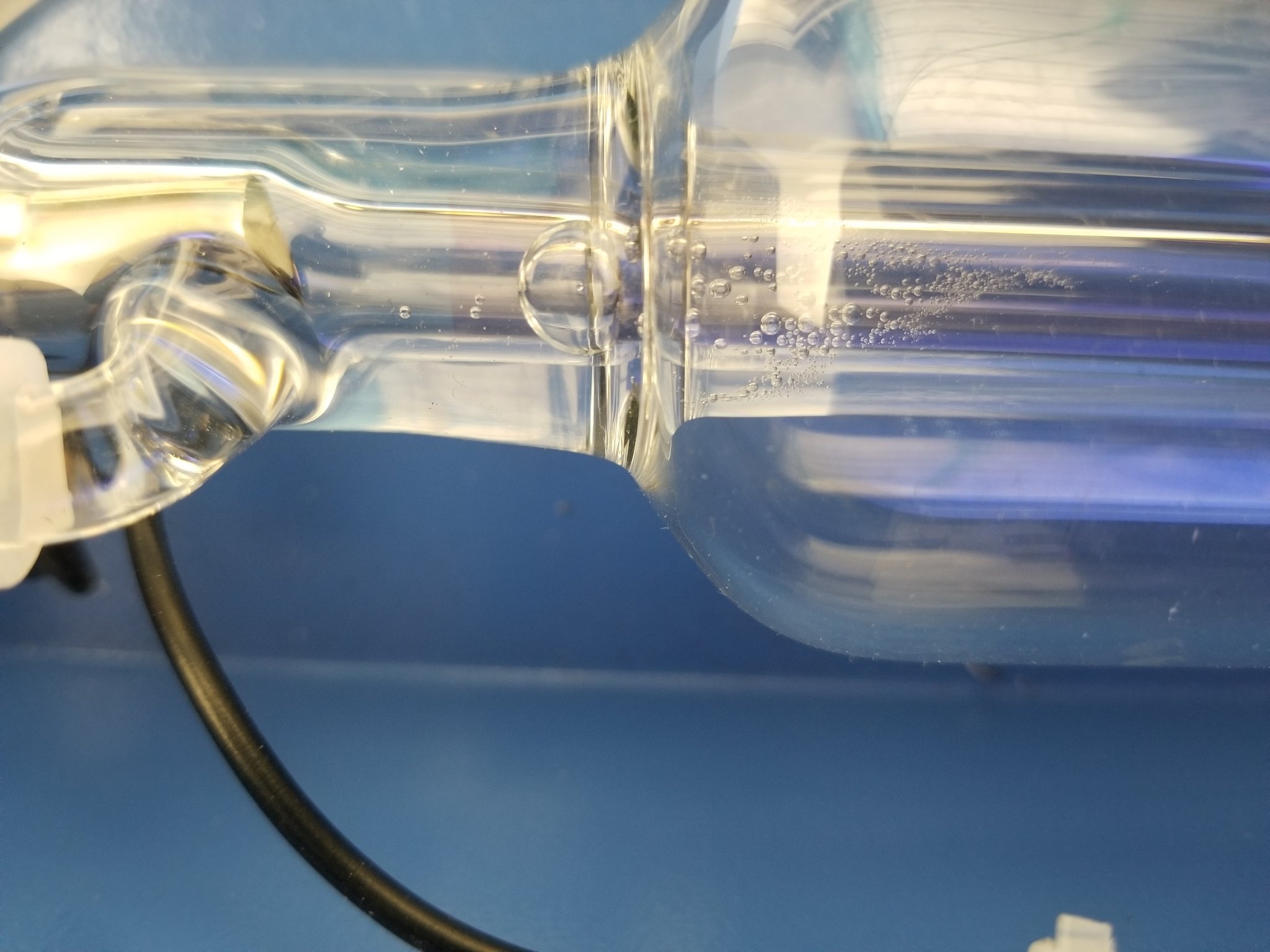

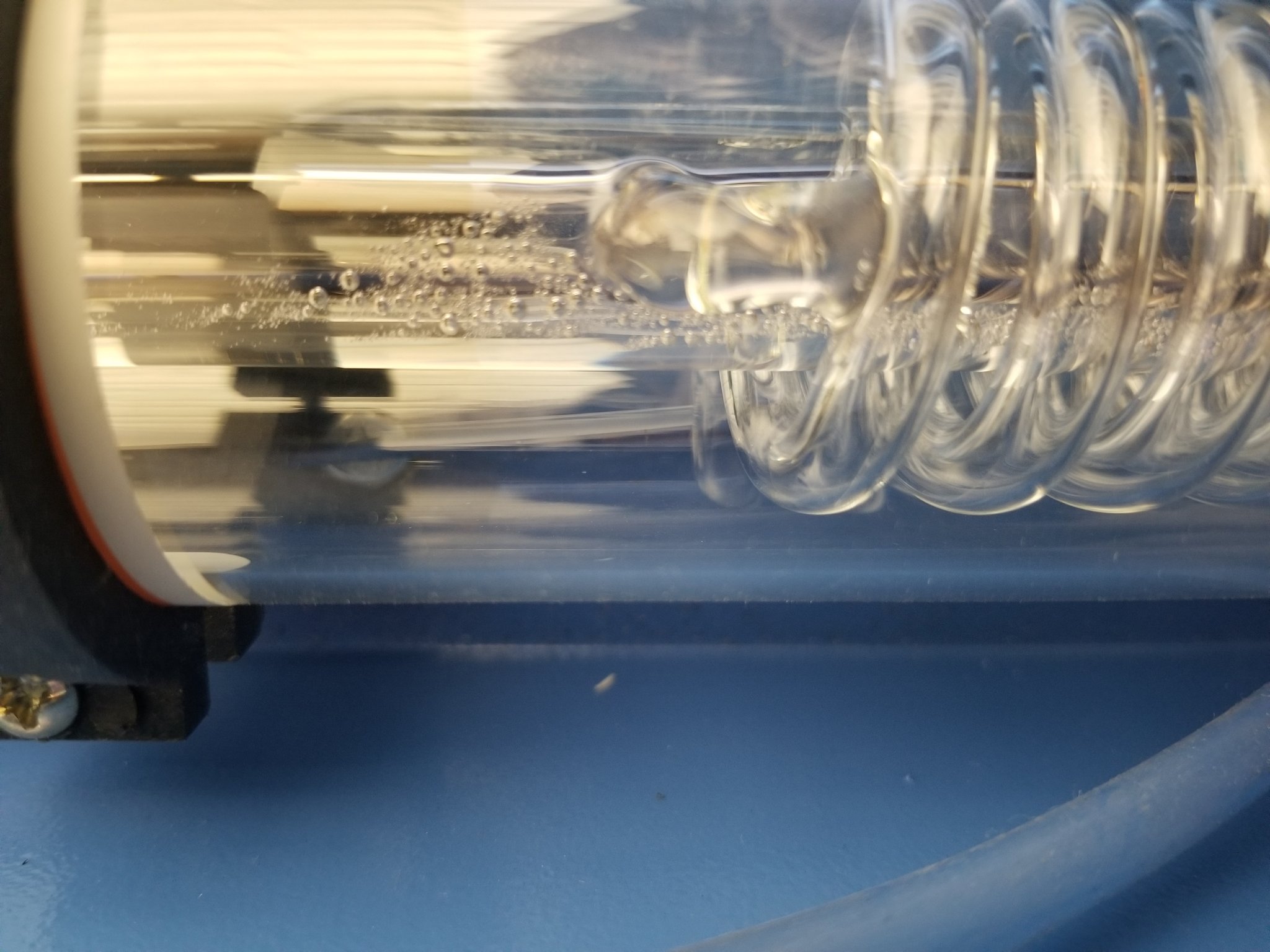

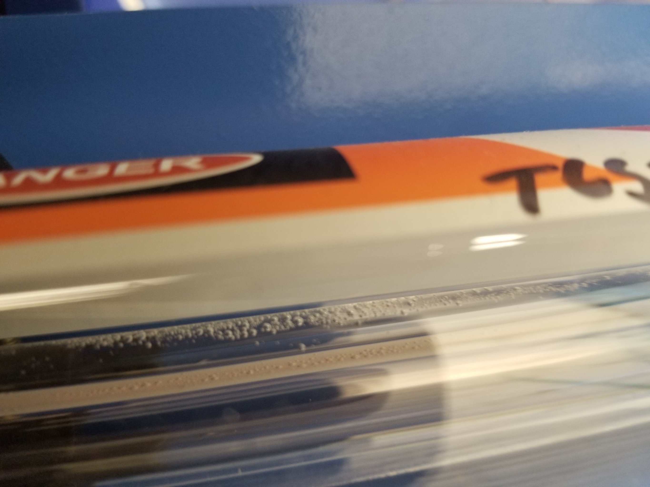

I believe I have a laser tube problem with my newly purchased laser tube. The new tube only has approx. 5 hours actual laser time and it was working fine a few days ago. Yesterday, I started noticing the lack of laser power with known successful program settings in LightBurn. I just replaced my original K40 laser tube about 1 week ago for the same exact symptoms. My best guess is something is wreaking havoc on my laser tubes. Today I opened the back of my K40 and noticed small air bubbles along the length of the tube. I attached photos of what I saw in the tube and the mirror alignment results I did right after noticing the lack of power. The bubble may be the root cause, but I'm new to this and I'm not really sure at all. If I have to spend another $235 for another laser tube, then I definitely need to research as many possibilities as possible, because the cost of two tubes will be more than a brand new K40 unit. I really need help figuring this out before it cost me a small fortune.

• I rotated the newly installed tube a day ago because I saw a larger bubble at the outlet side of the tube when I was aligning the mirrors. Once I rotated the tube, it was free of all bubble including the small ones.

the bubbles are not from the tube. it is from your water pump, make sure it has good pressure like 10L/min . a good way to get the bubbles out is to squeeze the silicone tubing a few times while it is running, remember bubbles in a tube will create hot spots and shorten the life if the tube.
