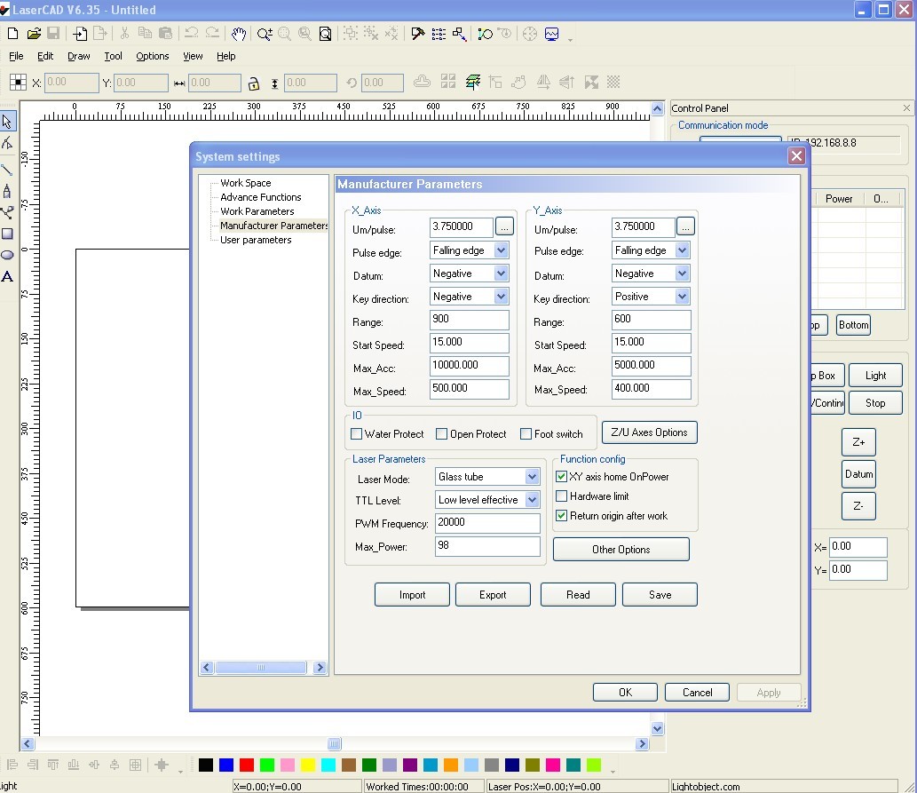

Now I read about a setting/choice that if incorrect will or can cause miss alignment issues....All I have to do is find where I read it
Found it ...look at the "pulse edge" setting. The manual says
"[Pulse Edge]: Trigger edge when motor is rotated by motor driver. If the pulse edge setting is not correct, may lead to cutting dislocation."
hope this helps
John
Indeed you're getting somewhere.
hope this helps
John

Thanks guys,1n2 wrote:Hi Dan
hope this helps
John
I will try these things later. Maybe i need to slow the engraving process down and have a look at the pulse edge setting. I am currently engraving at 100 mm/s or 150 mm/s maybe i should take it down to 50 mm/s and work up once i know its a mechanical issue.

Re: Dubstar_04 - 40w Chinese Laser DSP Conversion
Dan, what is setting of pulse setting on your DSP, Falling edge or Rising edge?
If you have Rising edge, change it to "Falling edge", one by one X & Y see if any improvement
dubstar_04
- Posts: 35
- Joined: Sat Jan 19, 2013 9:24 am
I am using the falling edge. Is it worth trying rising edge?
Dan
Dan
Tech_Marco wrote:Dan, what is setting of pulse setting on your DSP, Falling edge or Rising edge?
