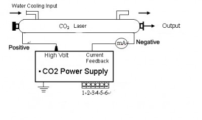

Hey guys, here are some pics with relative questions:
Where do we have to attach the blue wire that came from the laser tube and was connected to the resistor?
What about the resistor?
We took out the little card to where the flats of the stepper were attached.
Is that necessary or do we just connect the wires from the drivers to the motors?
How do we connect these and where?

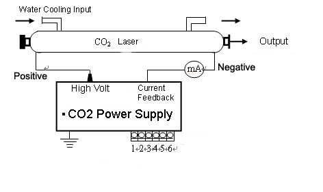

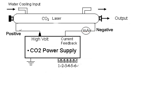

The blue wire is connected between the negative pole of the laser power supply and the negative terminal of the laser tube. The green "giant" is a current limiter to limit over (or high glitch) current. It came with the machine small machine because the came in power supply is no good and need this "giant" lower the current. Most likely that it could generate electric "glitch" the first moment of 'Fire' that the high glitch may hurt the laser tube (life span issue). If you replaced it with a quality PWM power supply, you can remove it.
The current meter must install in series with the load. In this case, you must install the meter in series(in between) with the negative side of the laser tube and the power supply. So, you connect tube's negative to the blue or green wire of the meter while connecting the other wire to the negative terminal of the laser power supply. Power it by DC5V and it should read the current for you. Remember that the respond time of this current meter is a little slow. It's good for use as current adjustment or during cutting. It won't be fast enough to monitor current flow during engraving.
See the attached image, the "mA"symbol = the current meter

Ok, we got the blue wire and the current meter.
What about the red card under the current meter in the picture?
Where does that one go? Or did you send it by mistake?

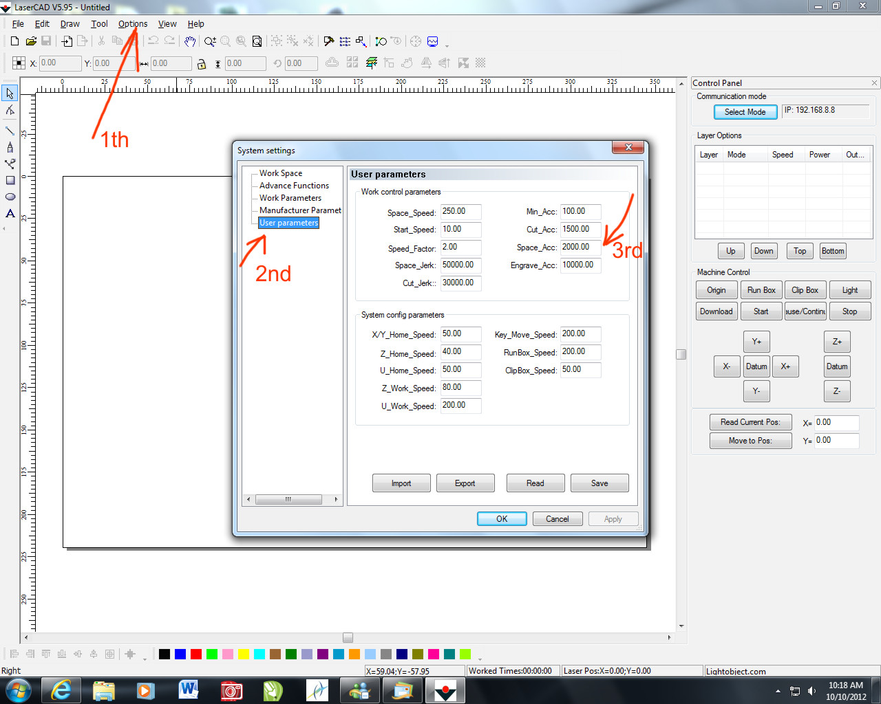

in the video the sound seams to have to do with your space acc set it down in the manufacturer settings.
the stepper driver sometimes need to be set to a higher setting ( 3200)
check your X- axis switch if he gets earlie enough engaged.

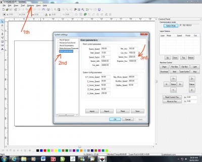

space acc is space acceleration setting in lasercut - opiton - system option - user parameter then see picture
the 3200 micro steps need to be set direckt on the stepper driver see manual
