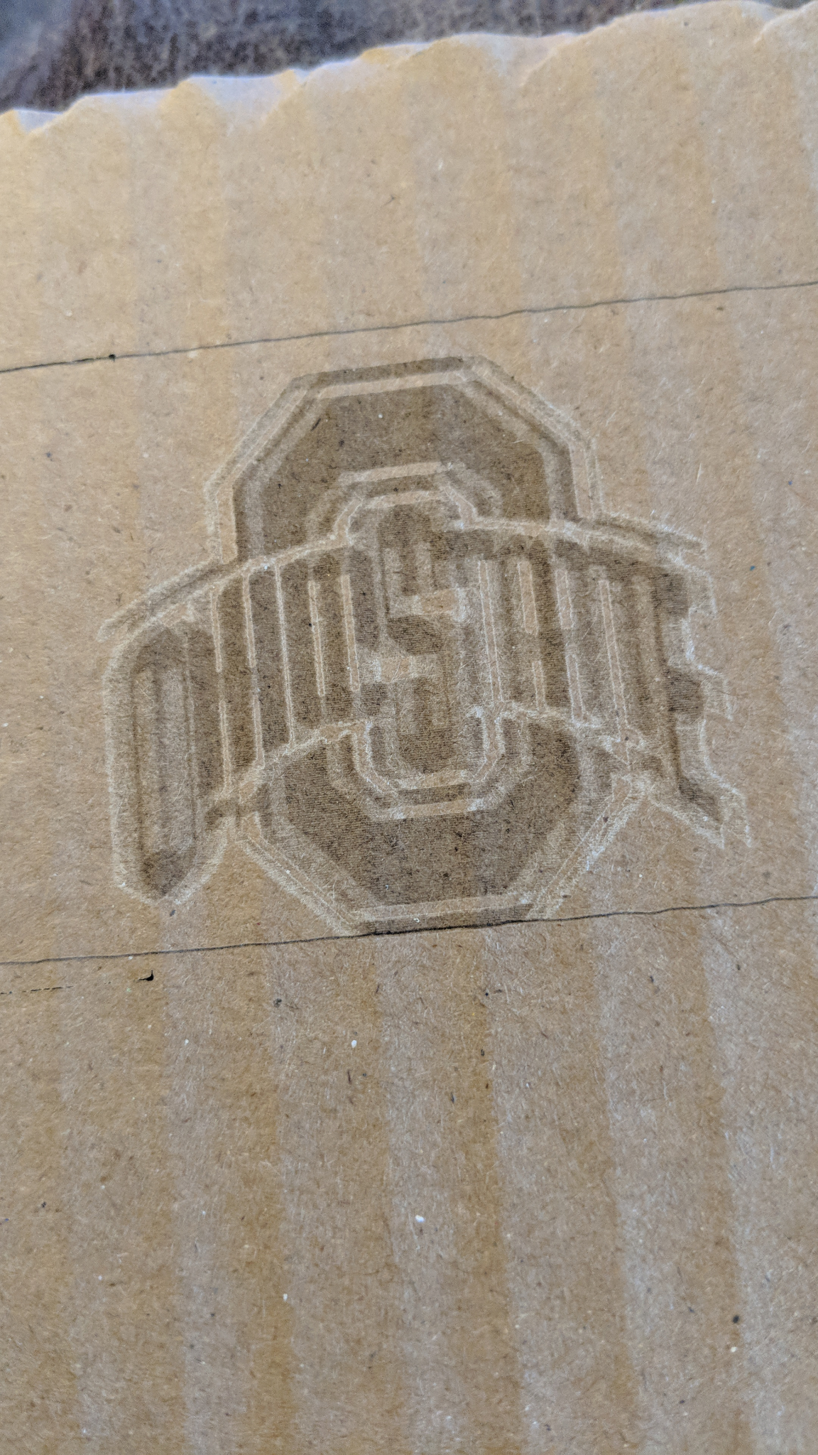

Thank you again Marco. I turned it to 3200 and that allowed me to fix the calibration issue now it cuts a 50mm square at 50mm! I've attached a picture that I engraved and for some reason it looks like it engraved the image twice so it's blurry. What would cause this?

Either you may have double image or the number count was set to 2. BTW, check your focus because even with two engraving, the result shouldn't be blurry at all

I placed a piece of cardboard at an angle and cut a straight line over around 300 mm and found where it was sharpest then measured that distance. Hopefully I didn't mess it up but I'll try it again just to verify. I will check that I didn't somehow have two images either and that the number was 1 but I'm fairly certain these aren't the issue. If they aren't is there anything else that could cause this? I may try on wood instead of cardboard though to see what happens.

Never heard that it could do engraving twice without the fulfillment I mentioned

I figured out the double engraving issue. Seems like the issue was backlash causing the engraving when the head was moving left vs right to not line up. I switched the engrave mode under laser parameters to Unilateral so now it only engraves when moving right and it fixed the issue completely.

If you're talking about double image that was caused by backslash, then I'll consider of losing focus lens. Unscrew the laser head out and shake it see if you hear noise. If you did, then the lens must gotten loosen. Also, double check other mirrors and make sure that all mirrors are secured.
