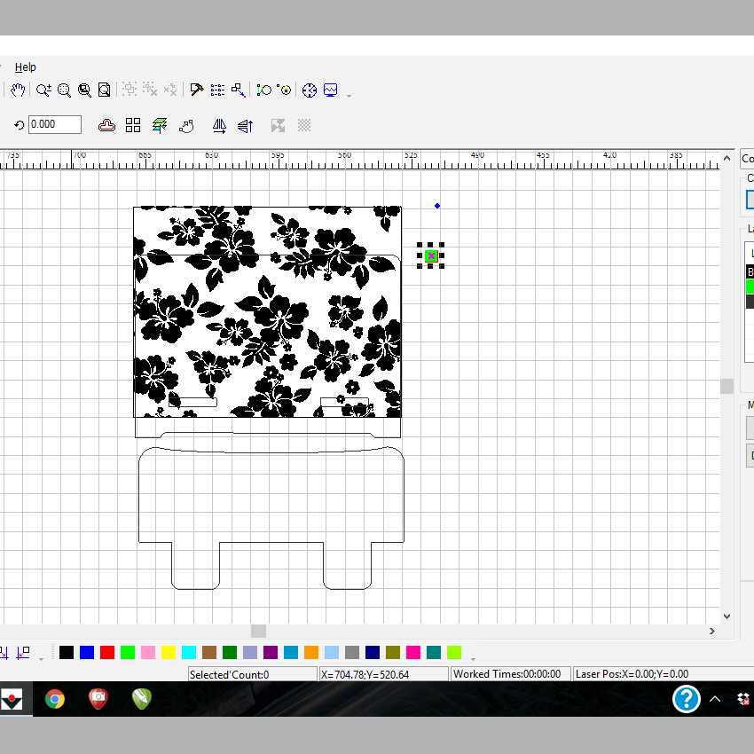

I am having issues with my recent AWC708C upgrade.
I am trying to Engrave & cut a 2 part project and I am having issues right from the get-go.
About 5% through the first part which is engraving it stops and goes back to origin and says "Engrave Beyond Size". Now this piece is nowhere near the size of my build plate. I checked the config and have the correct build plate size setup in the config. I even upped it to 2000mm x 2000mm and it still fails at the same spot saying "Engrave Beyond Size".
I am not sure what to do.

If you check the engraving layers first and uncheck the cutting-layers, send this to the machine and start engraving.. do you have a problem then?
If not, you can sequentially uncheck the engraving layers, check the cutting layers, send that to the machine and start cutting..
Else, can you post the file? see if i can reproduce your problem..

I'm wondering if this post help: viewtopic.php?f=75&t=2571
Remember that you must have two limit switches setup properly: X & Y
Most obviously mistake is not having matched 'Machine zero', 'Page zero' setup properly. Those two setting must matched the HOME limit switches location.
Also, if speed is high it need longer distance to accelerate and it will most likely go beyond the bed size. So, slow down the speed may help. Just give it a try

I found I had to draw a little box beside the job I wanted to run. Essentially what the machine wanted was to get up to speed before it got to the engrave spot. You can also reduce the engrave speed, sometimes it helps too.
