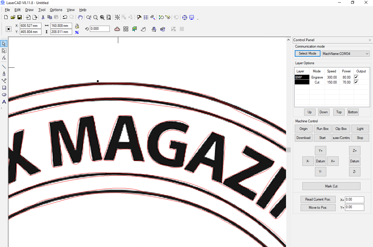

We are having an issue with the LaserCAD software appropriately outlining an imported image for a cut. Did not used to have this problem with the earlier software versions. The image has been created at a very high resolution that hasn't been an issue before. But the system is oddly choosing which lines to trace and even with poor accuracy for the lines it does outline. Usually happens on the interior holes of a letter like in 'e' or 'd' or 'a'.
Screenshot of the issue attached. Any advice on what could be causing this or if there's a solution we cannot find?
Using latest software version. Have tried V7.98, V8.10, and V8.11 and all have the same issue.
