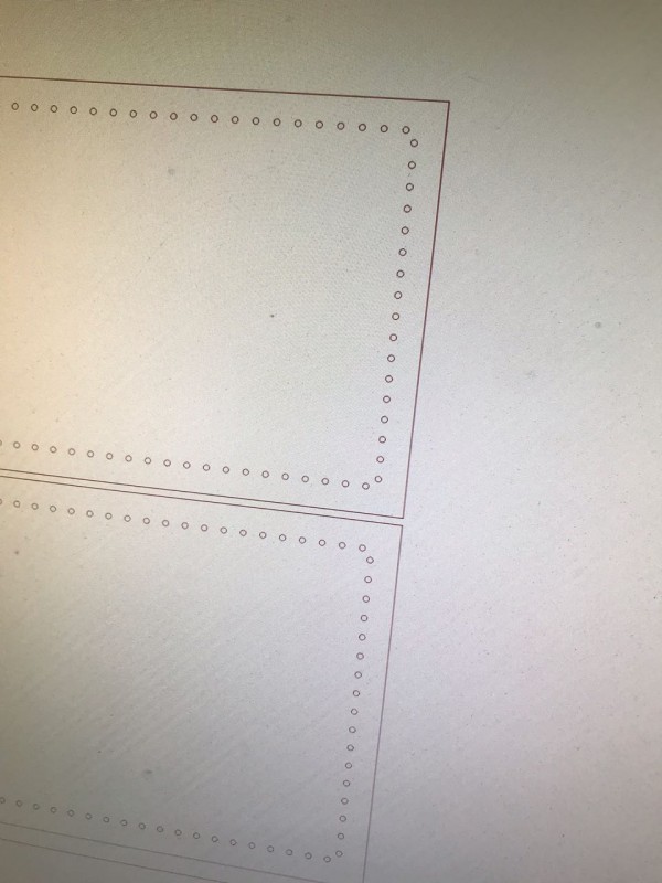

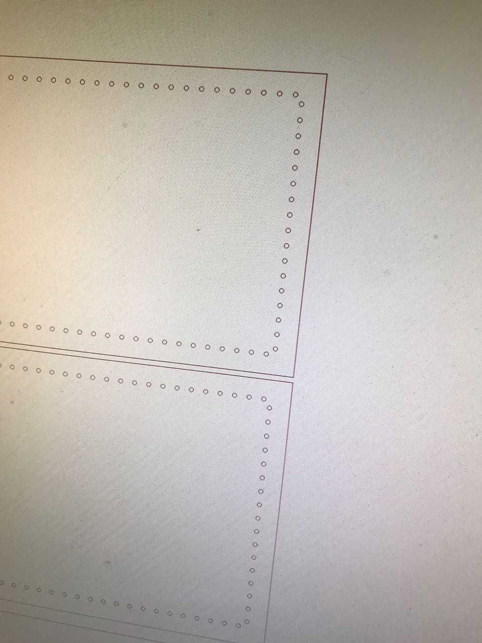

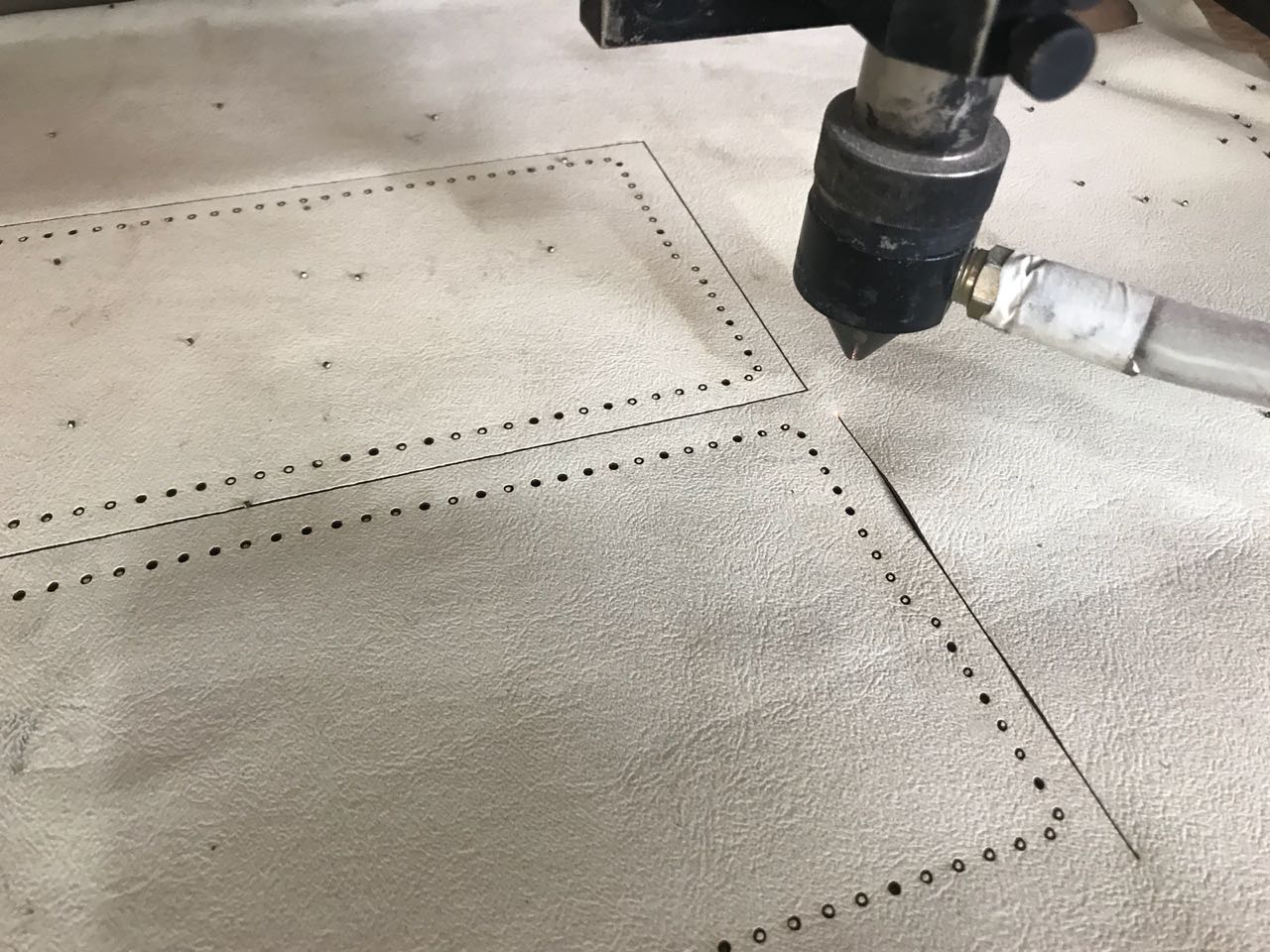

hi! i am having this issue for a log time and i can not solve it, when i cut files with lot of curves the curves sometimes misses de aligment

Please post your parameters for the manufacturers and the user setup. It seems that it was caused by mechanical issue.
Check laser head, mirrors, lens, and mirror. Those items may got loose somewhere. X7 won't do that for sure.

its not a mechanichal issue because it only happends with big files with lot of curves, i update the firmware and cut it again and it was ok, i hope that doesnt happend again.
