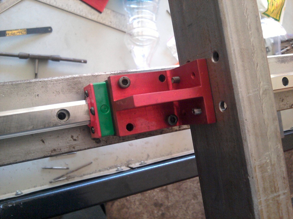

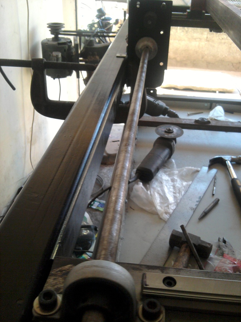

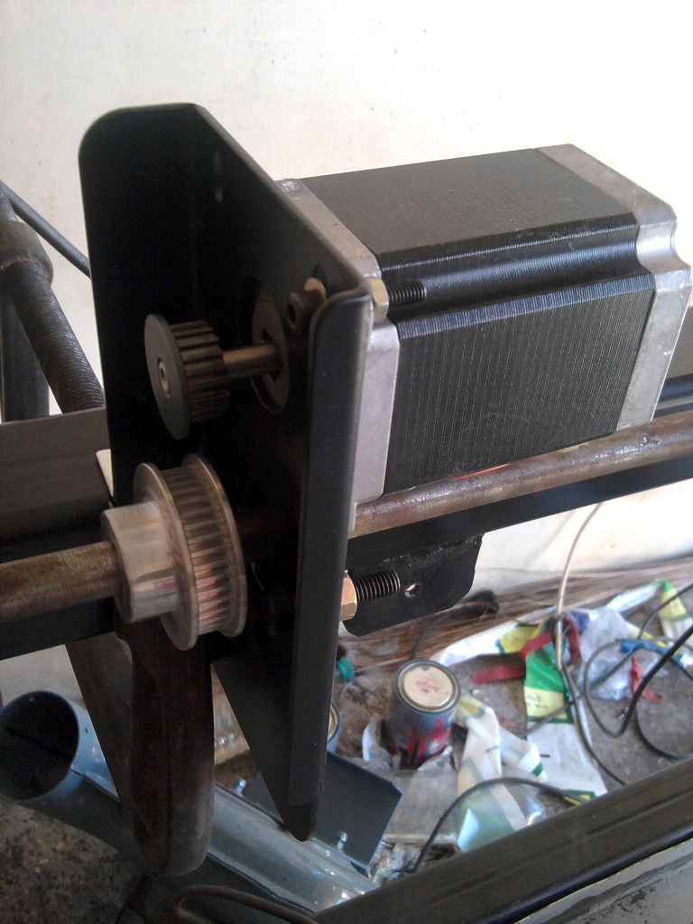

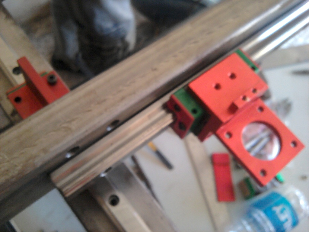

Re: My new machine
Some progress on the machine I am building
I was wondering if anyone can help me with some images of an idler setup also used as tensioner on the other end of the belt
Regards
Irfan
Regards
Irfan
