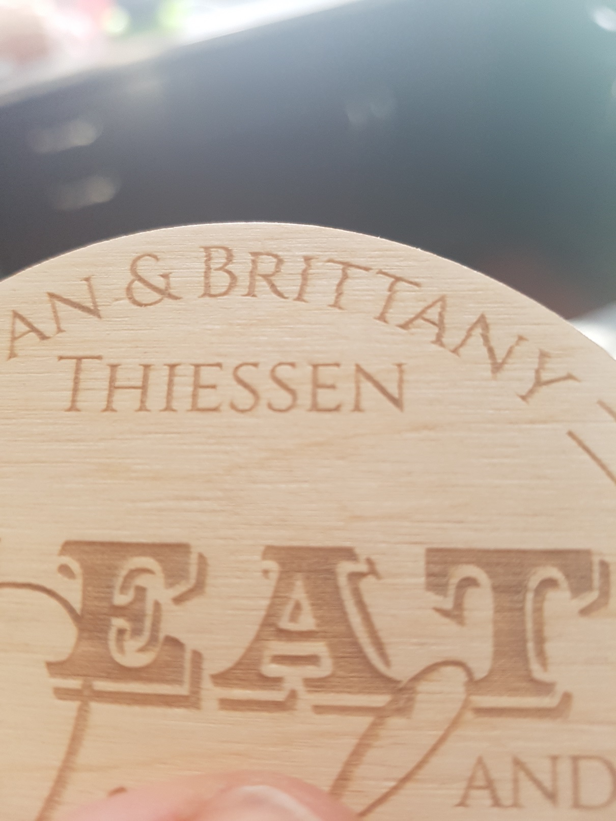

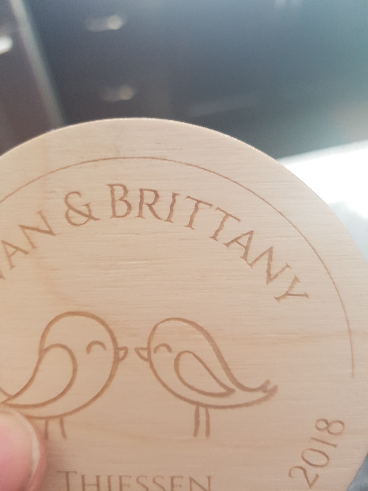

So, I've been trying to get around these engraving issues I've been having but I cannot for the life of me figure out how to fix it. It's really limiting the work we can do (having a business related this equipment engraving gets to be pretty important).
All files are vector based, made in Adobe Illustrator and goes through Corel Draw to be converted to a clean and functional DXF before going into here.

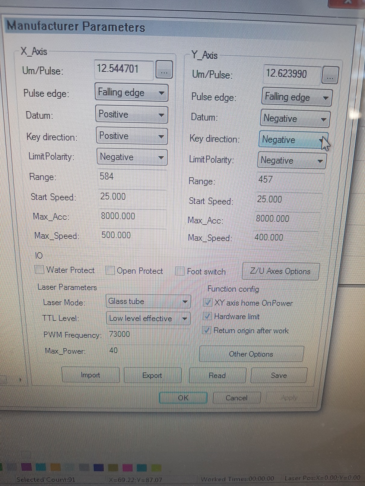

Here's my settings along with the issue you can see. We eventually caved and went to unilateralism because the amount of errors (rather the odds of the errors showing up) increased with bi-laterailism. Yes it takes more time...but it gave more clean engraving results but not 100%.
Ignore the PWM and power thing...this laser has been weird from the beginning and that's basically where the settings ended up landing and working years ago and didn't want to bugger up all the saved templates with the power profiles to adjust it to be more accurate. :lol:

But your problem puzzles me a bit.. The displacement is over more than one scan and not over the entire width, so i don't think it is a step you miss or a loose timingpulley, for instance..
That is, when you are lasering in both directions (Bidirectional)
What is the reason for this odd Um/pulse? Normaly there is a timingpulley of x teeth and a specified distance between them. for example: if you have a GT2 belt (Pitch=2mm) and your pulley has 50 teeth, every rotation of the stepper is 100mm travel. Your stepper needs the microstep times 200 (common for most normal steppers) to do one full rotation.. If the microstep is set to 1/16 it needs 16x200 = 3200 steps.
So every step wil move 100(pitch x teeth)/3200 = 31,25 um. This number more logical.
Some steppers do work better with an other edge (Falling/rising).. You might experiment with that.
Also something with timing is the PWM-frequency. Normaly 20000-25000 is fine.

It seems that some parts are getting loose. Check mirrors and lens make sure that those items are not vibrating. Since the speed you were using was pretty slow so I think you may have some parts got “really “ loosen. I don’t think it has anything to do with the DSP card

As for the steps, I think that was a product of the calibration sequence in the software rather than a formula driven attempt like how you laid it out. There might be a weird rounding error there that causes that? I dunno...I can have a look and try the more solid um step rather than the setup I have now.
I'll try the rising/falling edge portion as well.

If you're using one of our DSP controller, regardless X7, 608, or T9, there is 'um' calculator built-in
To see 'How to', check out my 'FAQ' from the main page of this forum

By the way, it sounds odd but the motor gear, the Y coupling, or the Y axis gear could be escaping (lost traction)
If the focus lens loose, it shake while the X swinging and problems like yours could happen . Just a quick thought coming from my brain while I was reading your post.

I have a suspcion is will be my Y-Axis guide rails. They are heavily worn out and need replacements...I wonder if they don't occasionally just 'catch' or 'hang' for just a moment to cause this jarring.
I really need to upgrade this old machine :lol: Anyway, I'll try it out and see if that solves my problems. Thanks for the troubleshooting, you guys are the best!
