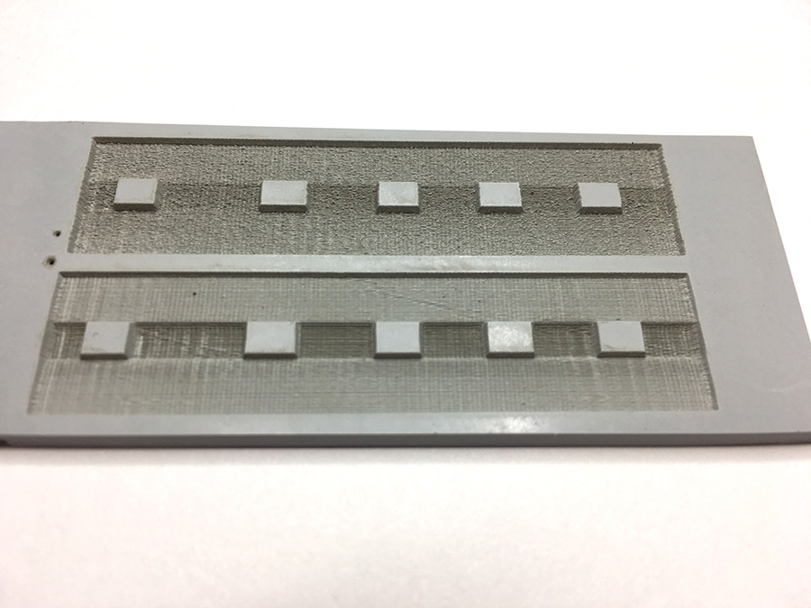

This picture is a test pattern to illustrate the problem. The rectangle is 3 in wide (75mm), and the bottom pattern is the original file. Engraving depth is 0.05" between the squares and 0.025" above and below them.
In the top pattern, I tried Techgraphix's suggestion and added noise to the black area in Photoshop to turn the laser on and off throughout the engraving area. With this, I'm measuring 0.045" 0.035" in the two areas. So it does help reduce the depth difference. It does add roughness to the edges so I'll have to use it in selective areas as a workaround.
I would still like to resolve the hardware issue and any troubleshooting suggestions are appreciated!
