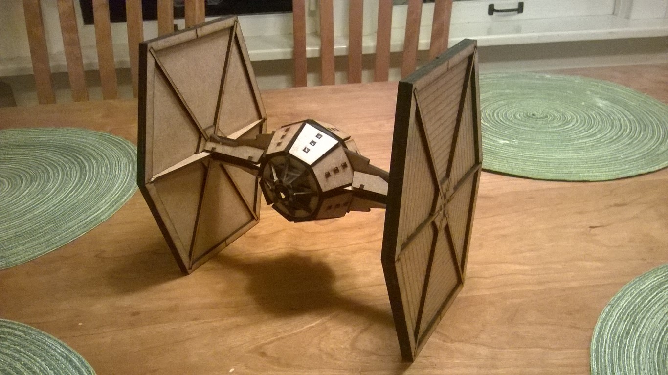

Our makerspace laser has a 45W tube from Light Object. It is not a problem to cut 1/4" baltic birch. This tube produces high quality engravings. here is an example member project using both cutting and engraving, with 1/8" hardboard, photo attached.
So... for our use, 45W is a good choice for cutting and engraving.
