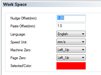

Out of the blue my laser is printing in reverse. Mirrored you might say. This happened once in the past and I was somehow able to get it to print correctly again but haven't been able to this time. I can't remember what I changed. What setting do I need to change? As of now I am mirroring the output before sending to the X7 DSP from CorelDraw so it prints correctly.

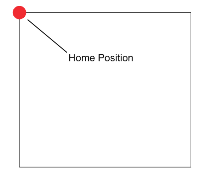

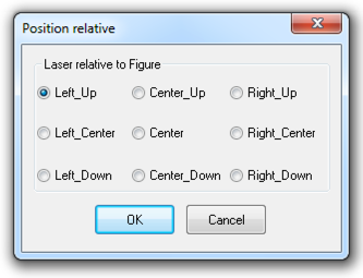

Check page zero, machine zero, and position relative. Make sure it match your physical home location. That should take care the issue

Thanks Marco for getting back so quickly. I check all the settings and they are all "Left Up" as should be. When I laser a arrow pointing to the right it will laser a arrow pointing to the left. This is pretty frustrating..
