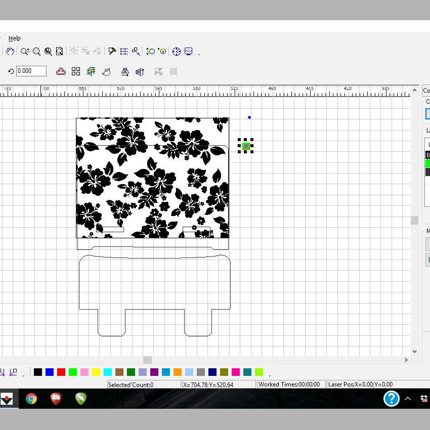

I found I had to draw a little box beside the job I wanted to run. Essentially what the machine wanted was to get up to speed before it got to the engrave spot. You can also reduce the engrave speed, sometimes it helps too.
