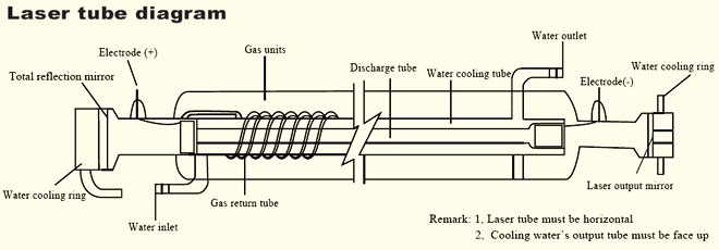

To which end of the laser tube does the red positive high voltage line attach?
40W tube
LSR-JN40W-1V
The manual online is for the 80W and I want to verify that the Red Positive High Voltage line goes to the rear and that the Negative return wire attaches to the front with the 40W

the anode (+/red wire) is the electrode by the gas return tube. the cathode (-/black wire) is the electrode by the output coupler.

Thank you. I shall rectify the situation. What happens if anode and cathode are reversed? Does laser fire other direction, bounce off of the rear mirror and fire out the front anyway?
