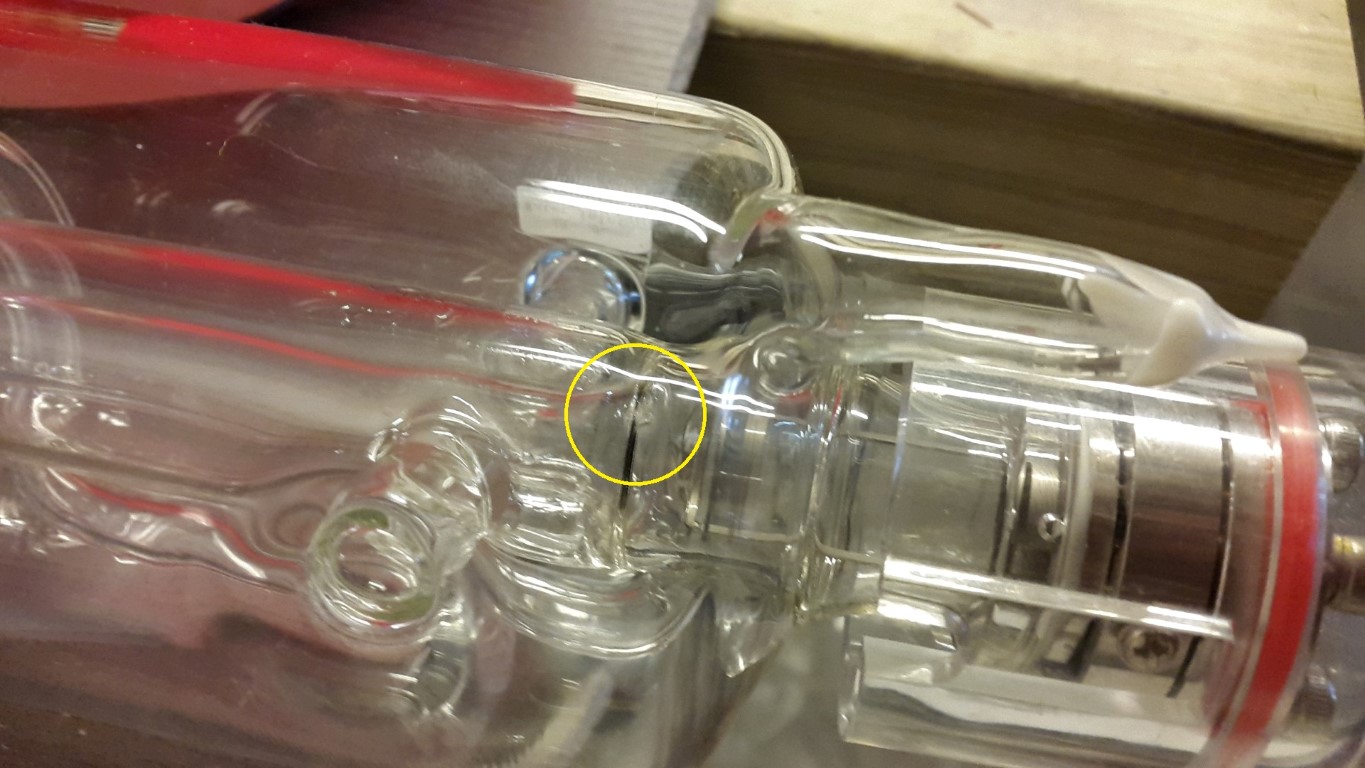

Last saturday my 100W Lasersaur stopped working. I checked the tube and found a tiny diffuse spot (tube 1.jpg) on the inner tube and there was a very tiny amount of water inside as well. I concluded the tube was broken and decided to replace it. We went to a local supplier of "Lasea" tubes and asked them to test it in combination with our (Reci) power supply which we brought along. Everything worked fine and we got a steady 108 Watt laser beam at 28mA power.

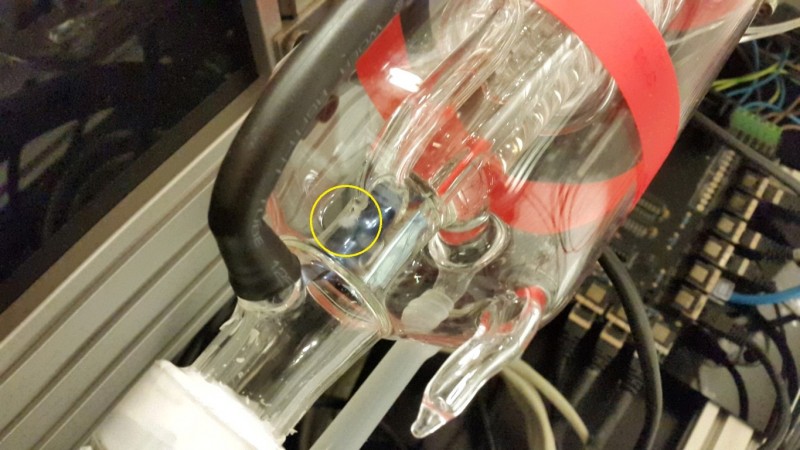

This morning we put the new Lasea tube in the Lasersaur and reconnected all the wires/hoses. We started with the mirror calibration process to see if everything worked again, but at 10 and 20% power we couldn't get a burn mark in the tape on the 1st mirror mount. We decided to try it at 100% and noticed a small diffuse spot, just like with the first tube, started to appear!! (see tube 2.jpg). The tube is now producing blue flames between the inner and outer tube, coming out of the tiny crack.

Tube 2
Tube 2
Tube 1
Tube 1

Our first tube was a 100W long life Reci from Coletech. After <1000 hours it died (see photo tube1.jpg at the beginning of this topic) so we bought a new one from a local supplier. This was a "Lasea F4" also 100W and I believe the diameter is 80mm. Sadly it died again after a few seconds of use (see photo tube2.jpg). We think the PSU might cause this an needs to be replaced as well.
