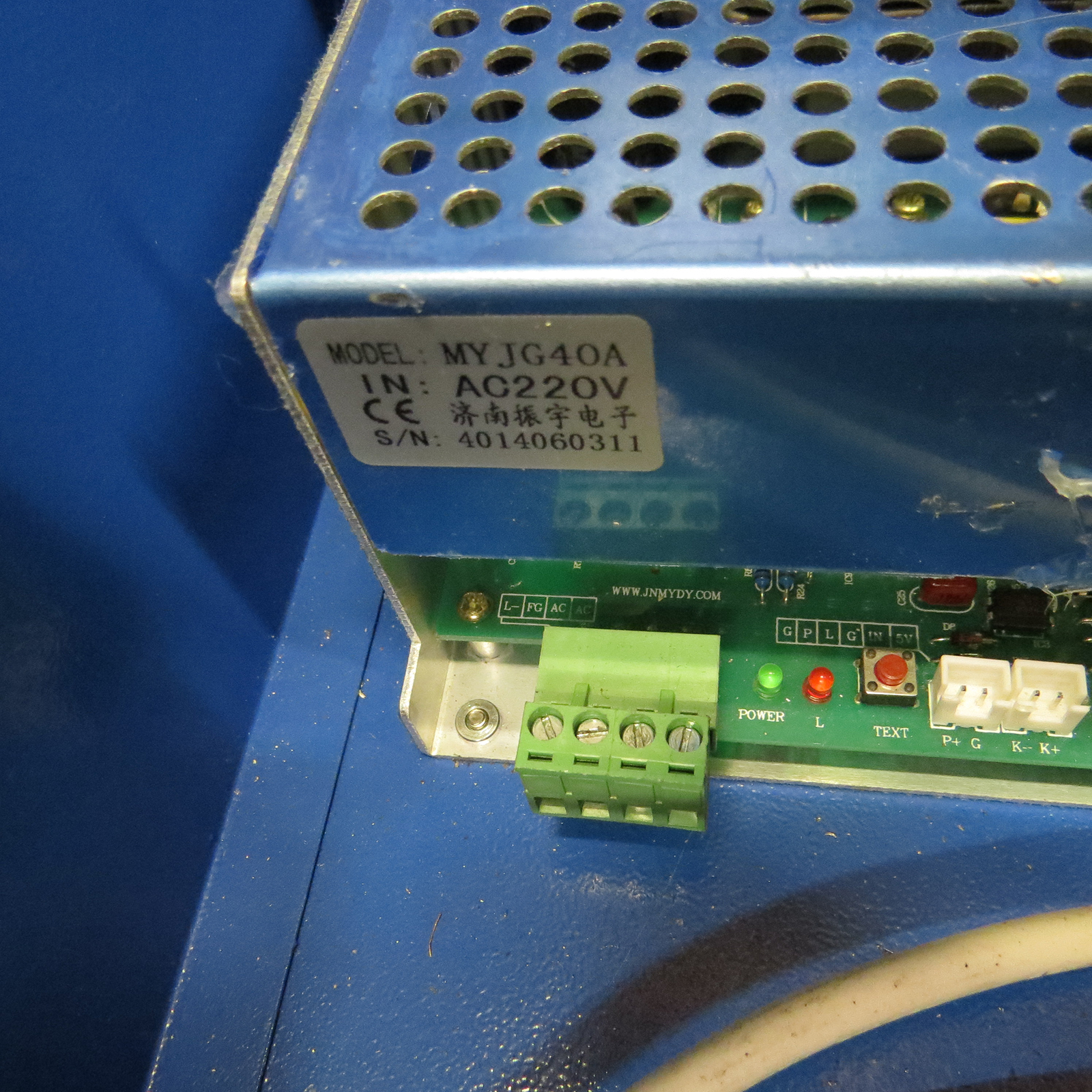

Has anyone any idea how this laser psu, wires up, as the labeling is nothing like in the upgrade wiring diagram?
Also the wiring diagram doesnt show V+ & Ground connected on the X driver is this correct?

Is there another 4 pin plug on the far left that looks like the one on the right side? Can you supply a picture just a little further away?

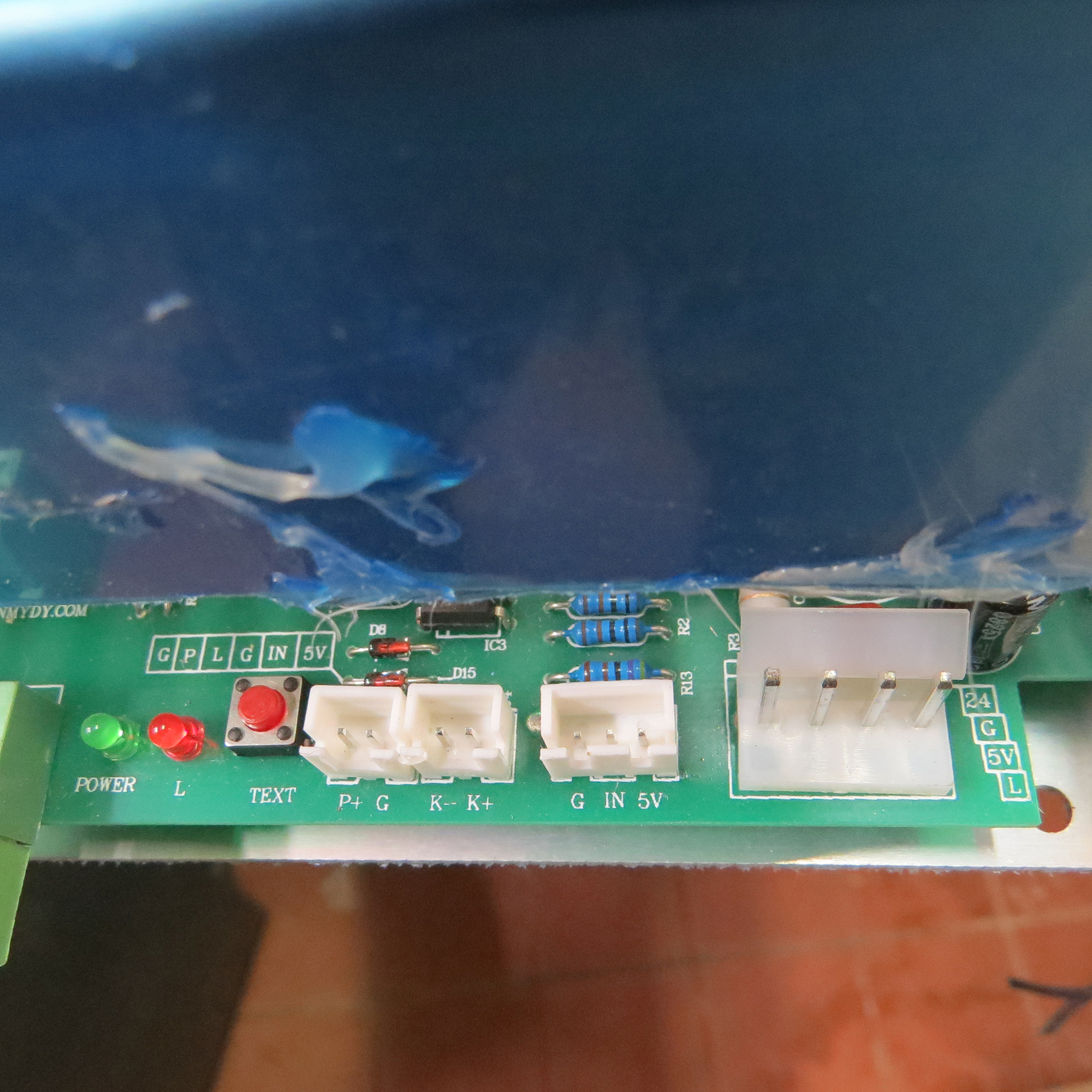

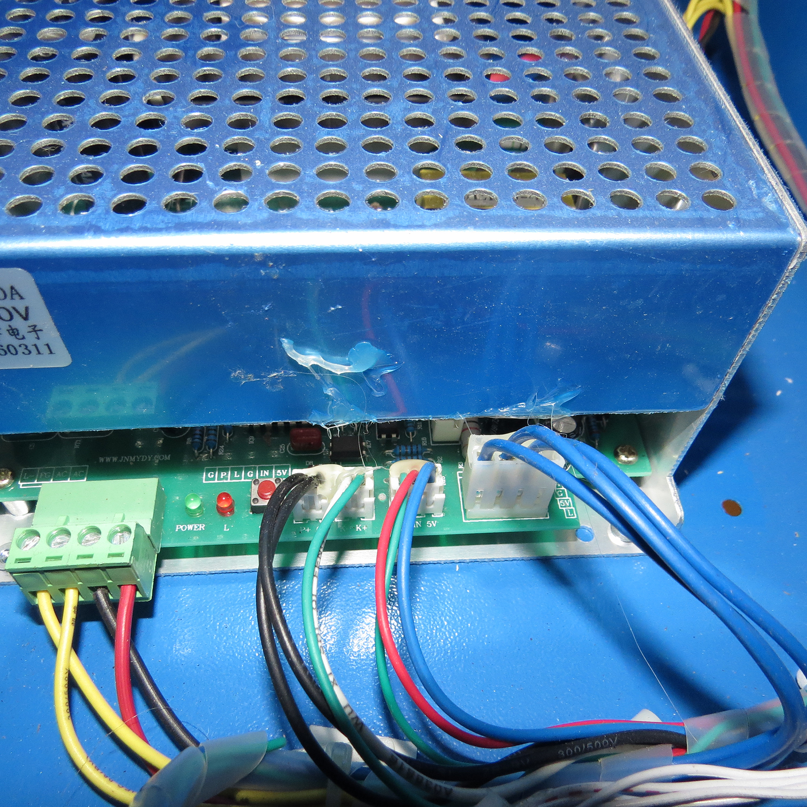

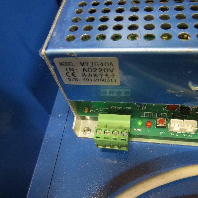

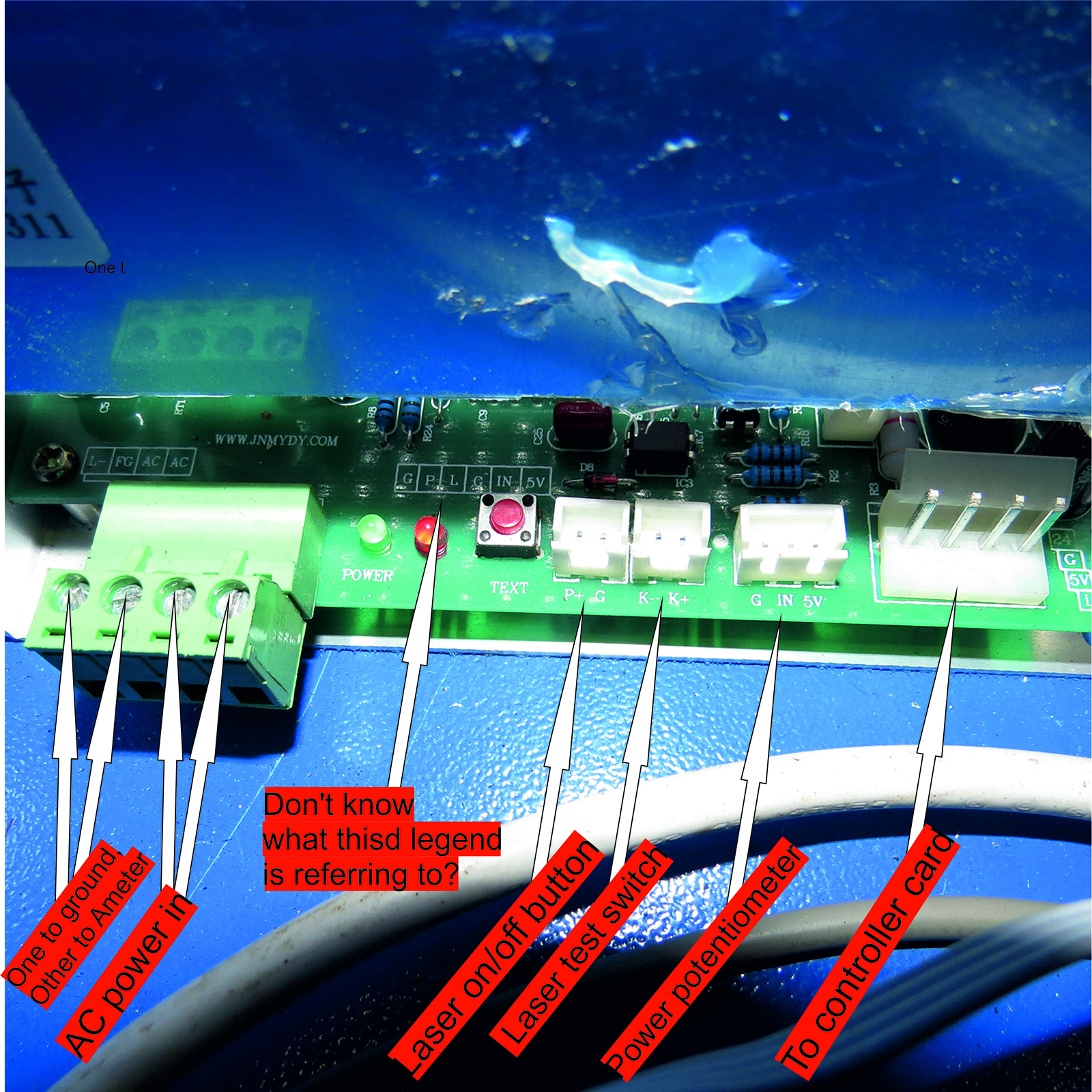

Hi Mike, here you go.
A bit more info, I've worked out.
