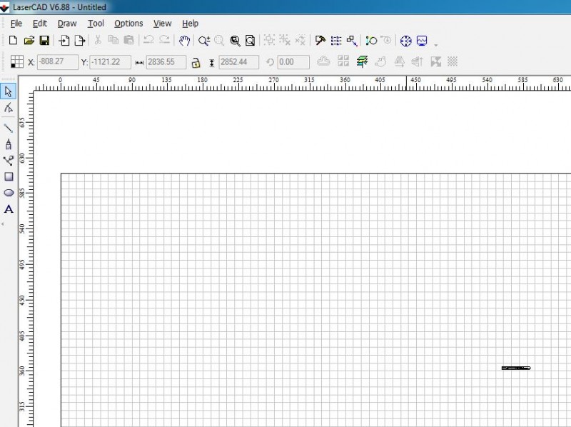

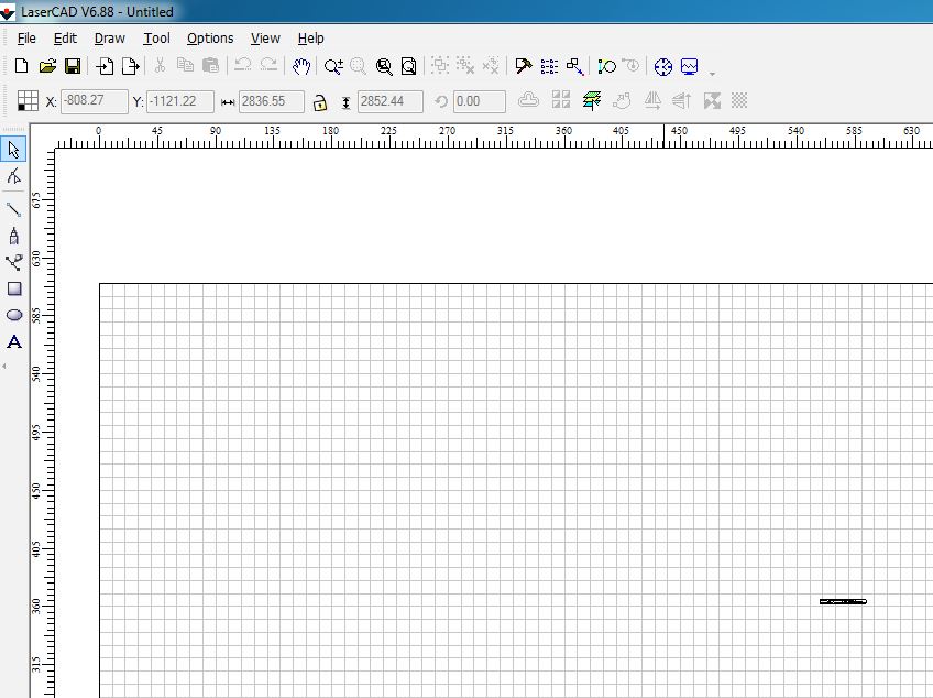

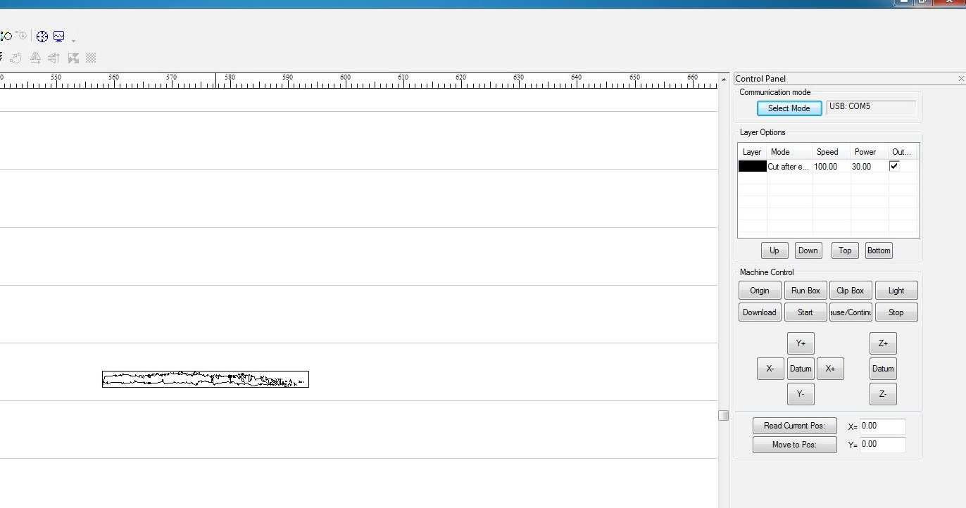

I'm having some problems importing AI files into LaserCAD. When I do the import, the image comes in as
either jibberish or all the objects are scattered all over the place. Any color information seems to be lost
as well - all the lines are black, not red/blue/whatever.

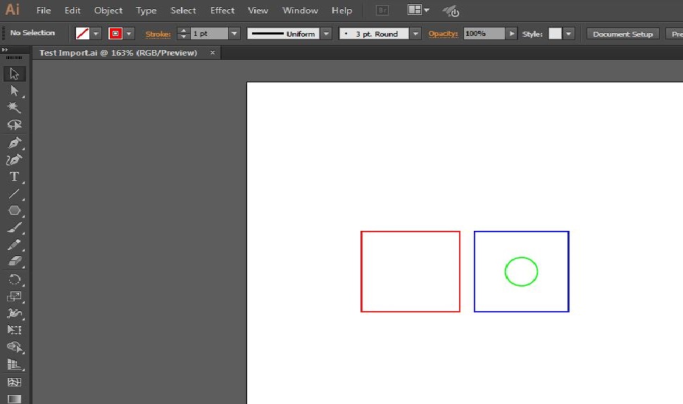

I'm using the latest version of Illustrator, and saving the file with no compression. Do I need to save it in a
prior version of Illustrator? If so, which one?
