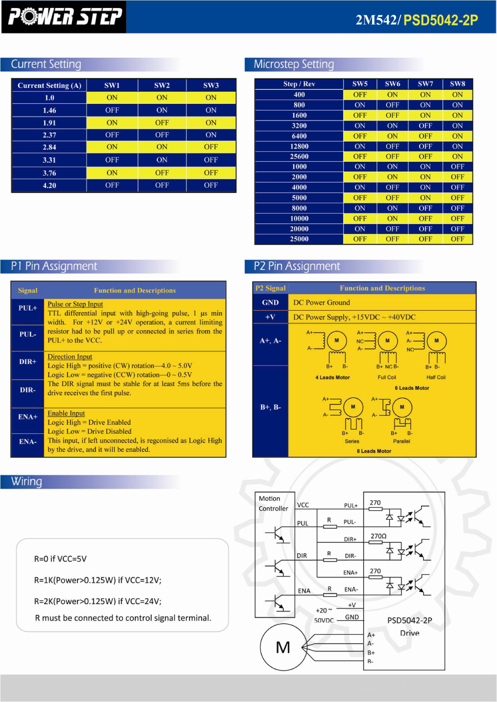

OK I got it instead of following the drawing I followed the actual manuals and figured out that on the driver to ignore the enable and to hook up the dir and pulse and ignore the part where it says ignore the negate terminals of dir and pluse. Really simple and easy to understand as long as you do read the directions
Basically
PLS+ goes to PWM+
PLS- goes to PWM-
DIR+ goes to DIR+
DIR- goes to DIR-
ENA+ is not attached
ENA- is not attached
Basically
PLS+ goes to PWM+
PLS- goes to PWM-
DIR+ goes to DIR+
DIR- goes to DIR-

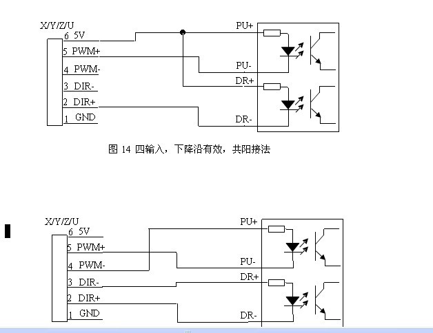

I got a reply from my test engineer. See picture, it's the correct connection for the DSP and the 542 driver
You can pick one of connection and it should works fine (see the 3rd picture).
Yours seems wrong,
PLS+ goes to PWM+
PLS- goes to PWM-
DIR+ goes to DIR+
DIR- goes to DIR-
it should be:
PLS+ goes to PWM-
PLS- goes to PWM+
DIR+ goes to DIR-
DIR- goes to DIR+
So, the power tripping got it fixed right. Ground problem issue, very common!
