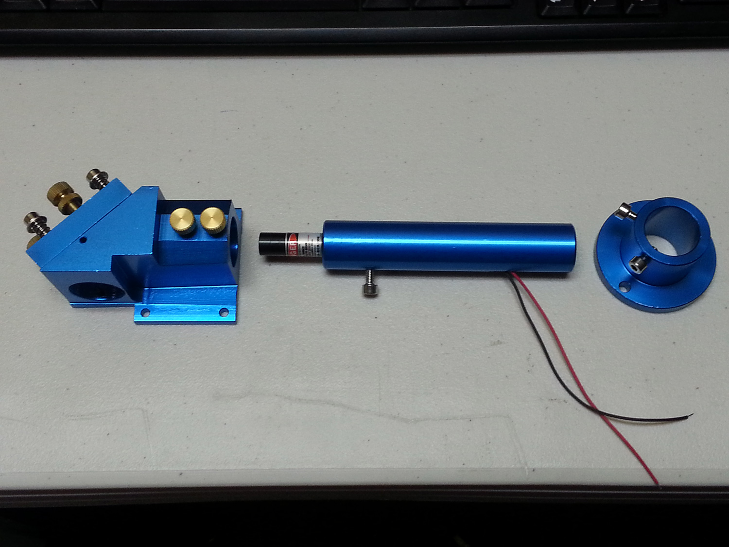

How does one assemble the laser diode into the beam combiner tube?
I bought this http://www.lightobject.com/Pro-25mm-bea ... -P872.aspx
It comes disassembled but no diagrams or instructions nor can I find any in the documentation section.
Then again, I could be blind.
Thanks.
Andy
Re: Assembly of laser diode into beam combiner
Open the base stand and inserted the pointer from the opening.

Tech_Marco wrote:Open the base stand and inserted the pointer from the opening.
The yellow arrow I added points to the screw that retains the diode in place. Is this correct?

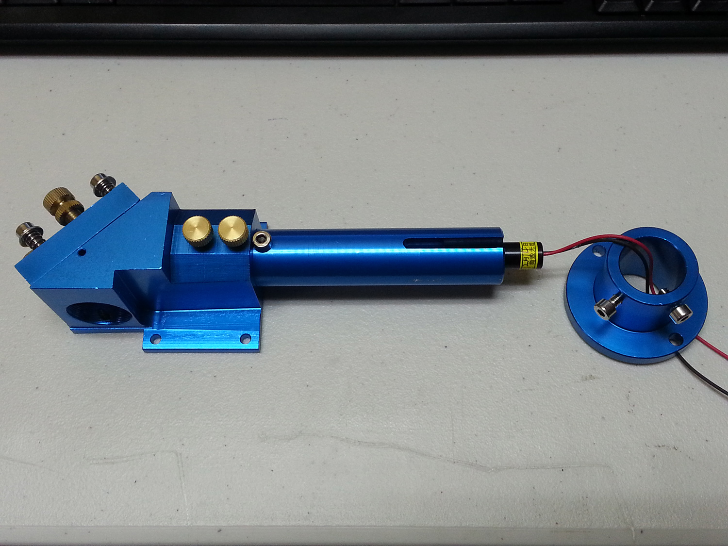

Correction: see image below
Note, in order to be able to aim at the center of the combiner lens,the upper piece of plate must be separated from the base by roughly 2~3mm gap distance. Otherwise, the red dot always hitting to the side ring of the lens holder
