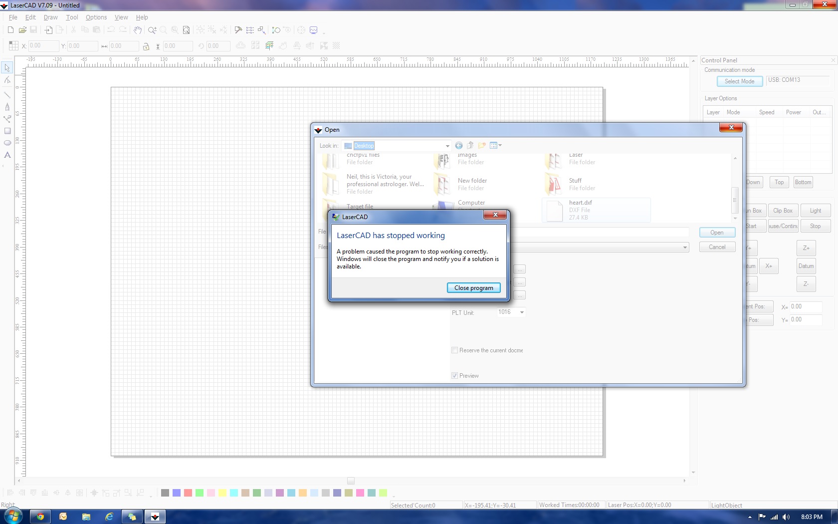

Re: LaserCAD crashes importing some DXF files
Hi all,
Well I just tryed to open the heart dxf file an I got this (twice)
hope this shows what it is doing, I could not open it I might try it as a Ai file
