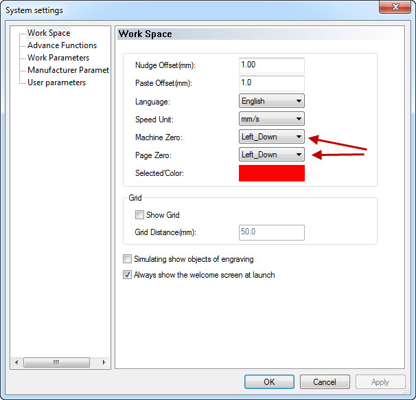

If you have "Work Space" set wrong, that will also result in the error you are seeing.
These are my settings. Yours may not necessarily be the same.
- WorkSpace.jpg (81.6 KiB) Viewed 3402 times
