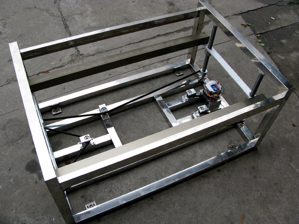

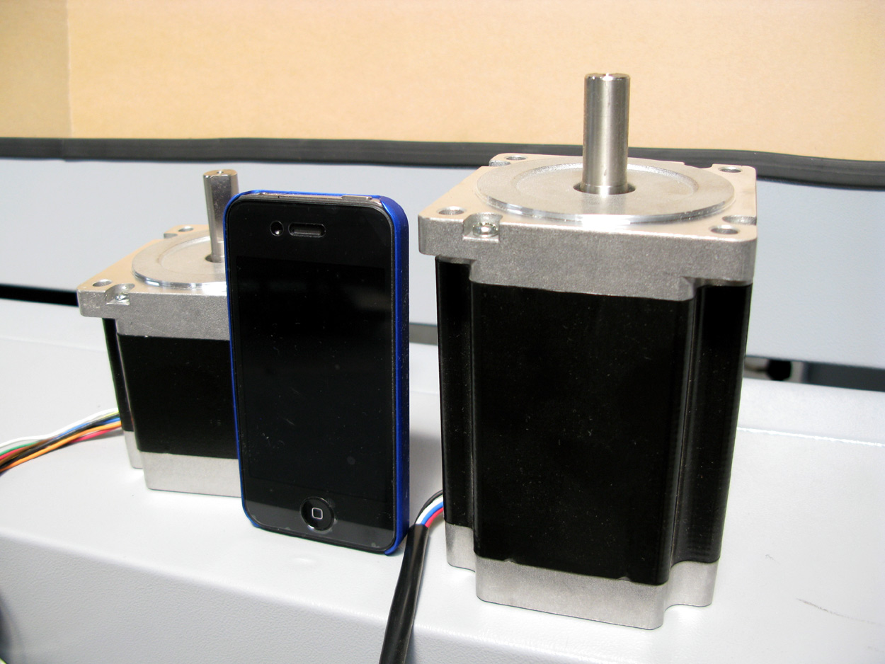

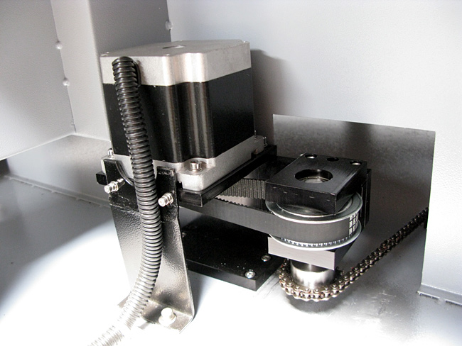

- Posts: 4654
Re: Lead screws and the z-table
For such big power Z table, a regular Nema23 (57 series) motor is not goind to work. Plus, you got to have 2:1 reduction gear
See picture I attached on our machine. Note the small motor size when compare to a Iphone. It is used on a 600x900 machine. It is "86" series motor with 7.8A current if I'm not forgotten. That I conclude that by using a Nema23 motor, your system (without 2:1 gear) may not be able to move at all .
- Posts: 4654
Update: I have 3 power Z table samples (in different size) coming from an ocen shipment scheduled to dleivery on Nov 23. The Z table is very heavy I guess it is over 100lb with stainless steel frame. It is a monster to use!
