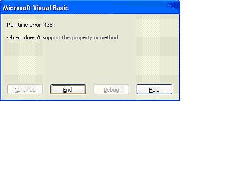

Bad news: When I press the run button icon with a blank or new page it starts LaserCad just like my x3 version of Coral.....but if any artwork, even a simple circle, is on the Coral draw screen I get the following error when the run button icon is pressed.
My CoralDraw x3 version continues to function just fine.

Wayne:
Use V6.77 instead as only V6.81 came with X6 plug in. Beside that, there is no difference
I'll contact the programmer to check if there is any bug. If so, I'll ask him to fix it
