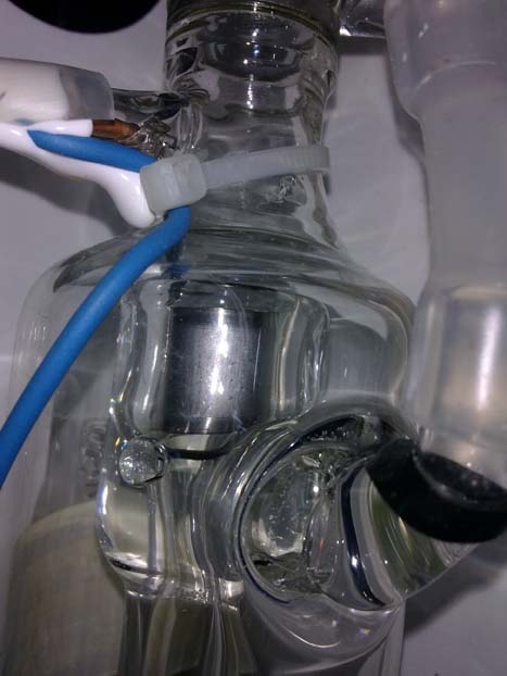

Re: K40 upgrade fail upgraded to pass
Thanks to waltfl for good advice: begin at the beginning... and to hardshoe for feedback on laserpower %
1) Simplified wiring and verified connections 2) Eliminated 100mA meter and shunt wiring which I had connected to 5V on Laser PSU
Baseline: Laser fires at preset power from TEST button Laser and WP LED fully on.
Cooling water level too low pump was drawing air: Added distilled to reservoir= Increased waterflow better water exit from tube behavior > nice bubble
Connected DSP to 24V. Did not verify 24V power supply output indeed 24V created test rectangle ran file... 27mm(X) x 123mm(Y) [def. step probs]
Low power TL in 12-15% range delivered a very nice line but once I changed values from Interface to 30%Power laser firing random. Origin issues!
Although basic wiring remains a factor I suspect the K40 IV power supply delivery of Low Power TL signal with DSP (12-15% range) is dodgy. I changed the max power in LaserCad to 30% file would run but laser did not fire right away as laser head moved around- USER issues that I will solve soon.
Thus it is clear I still have possible issues with either soft origin/and dip settings or both and wiring to Xmotor... need to read through posts again ...
I referred to the SZ80PowerSupply manual even though i don't have this model (i don't what I have actually) I see the 5V makes a connection across all from TTL through G when closed with INput is the analog ) is 0-5V in the general diagram... perhaps I created a problem with pwm by connecting the V+ for my 3digit digital meter in the 5V... it does seem to receive feedback at Power on and hovers between O and 1.

hi there again
first there never should be air bubbles in the tube this will destroy the tube
there must be a bridge between the WP and Ground on the laser power supply
suggestion you need to talk what you are doing with the machine so I can understand better to give advice like the last point her
...I refer to the SZ80..... I got no idea what you talking about
why you don't try first to use the existing analog mA meter it does not need extra power just put it between the negative connection from the laser powersupply and the negative connector from the tube the blue or black one no resistor.
the wiring of the stepper motor is easy like shown on the schematic never drive the stepper driver without a motor or you destroy the driver happen to many as they try to test the driver without motor.

Re: K40 upgrade pass
Thanks Waltfl for clarity on the laser tube and air bubble- I was under the impression that a small bubble near outlet was ok. I cleared the small bubble near top outlet by rotating the glass laser tube slightly, very slightly up to center. Amazing the difference this small change of a couple of degrees made; the persistant air bubble cleared and the tube remains air free.
The power supply manual is for a PS sold by LO specifically for an 80 Watt CO2 laser but it is a good reference tool for wiring diag.
I wired my x stepper as per the K40 conversion B manual using the pictures for ref. wiring is straightforward but motors may differ.
Attempted to update firmware on DSP608 from USB stick FAT32 but only 2G in size (drive reads as less than 2G). This size of drive not recognized > screen msg 'No Ufile'
I will have to purchase a newer USB stick 2-8G.
