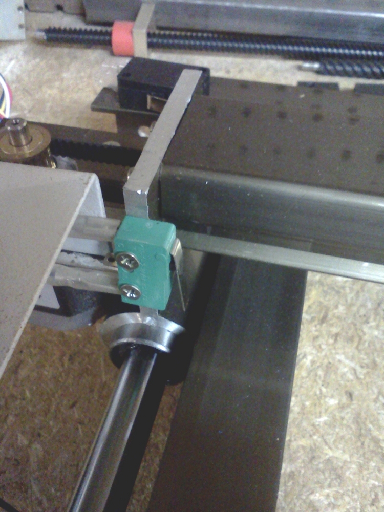

I have a question about the x-axis limit switch. My k40 came with one already installed and I really like how small it is and where they put it. I was going to take it off and put on the one that came with the kit but I'll lose a bit of motion on that axis if I do that.
My question is... Would stock one work ok with the dsp kit? I have attached a photo of it.

Yes, it looks ok to me.

Thanks for the quick reply, using that limit switch will free up a bit of movement for me and I can use the spare switch that came with the kit on the door.

just check the switch for the correct working connect on close.

The existing X axis switch works good for my conversion. I made a custom PC board to mount the Y axis switch to in the same place that the optical one was (and removed the the metal flag that triggered the optical). By using the existing X switch and custom board for the Y switch I was able to maximize the travel available on the top end. The maximum X travel is what it is but I was able to gain significant more Y travel in the positive direction by trimming the "garden hose" stop. Here are some pictures of mine:
X axis (note by default it was wired normally closed, DSP will want it normally open. Use the middle and top contact, not the bottom and top):
Y axis (note that this switch hits the aluminum rail in the back about where the optical flag was mounted.):
Good luck with your project. My conversion went really smooth, hope yours does as well.
