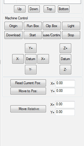

A "Move Relative" button would be a handy addition.
Greolt

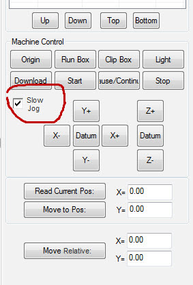

A "Slow Jog" check box would be good too.
This could enable a 10% jog speed.
