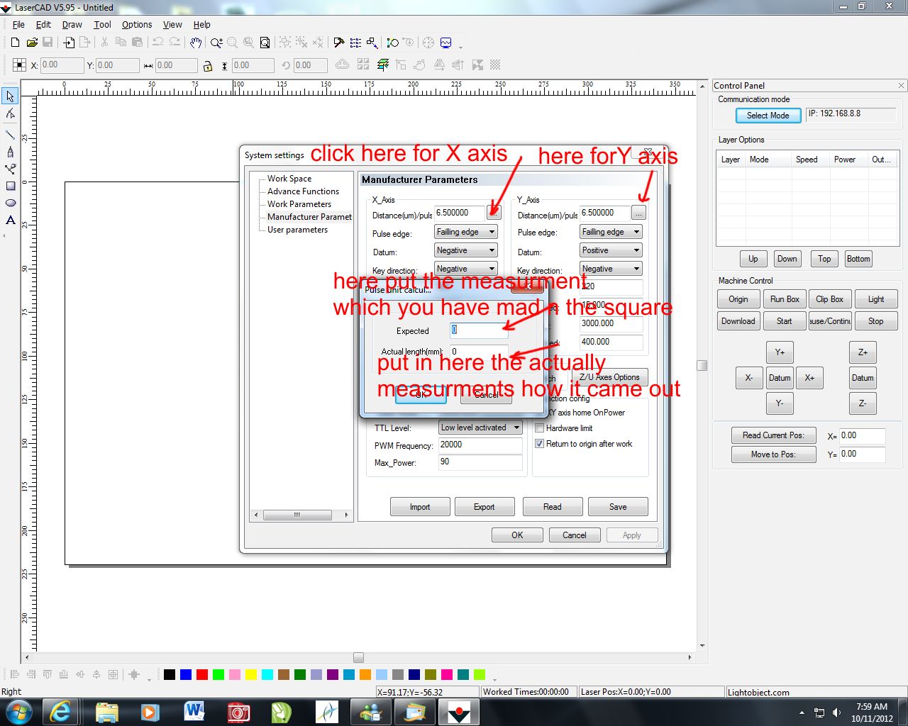

this is a probleme with adjusting the machine with a test square .make a square in laser cut set it to cut 15% and 80mm/s speed then cut it
then follow the picture

Thank you very much Problem Solved
