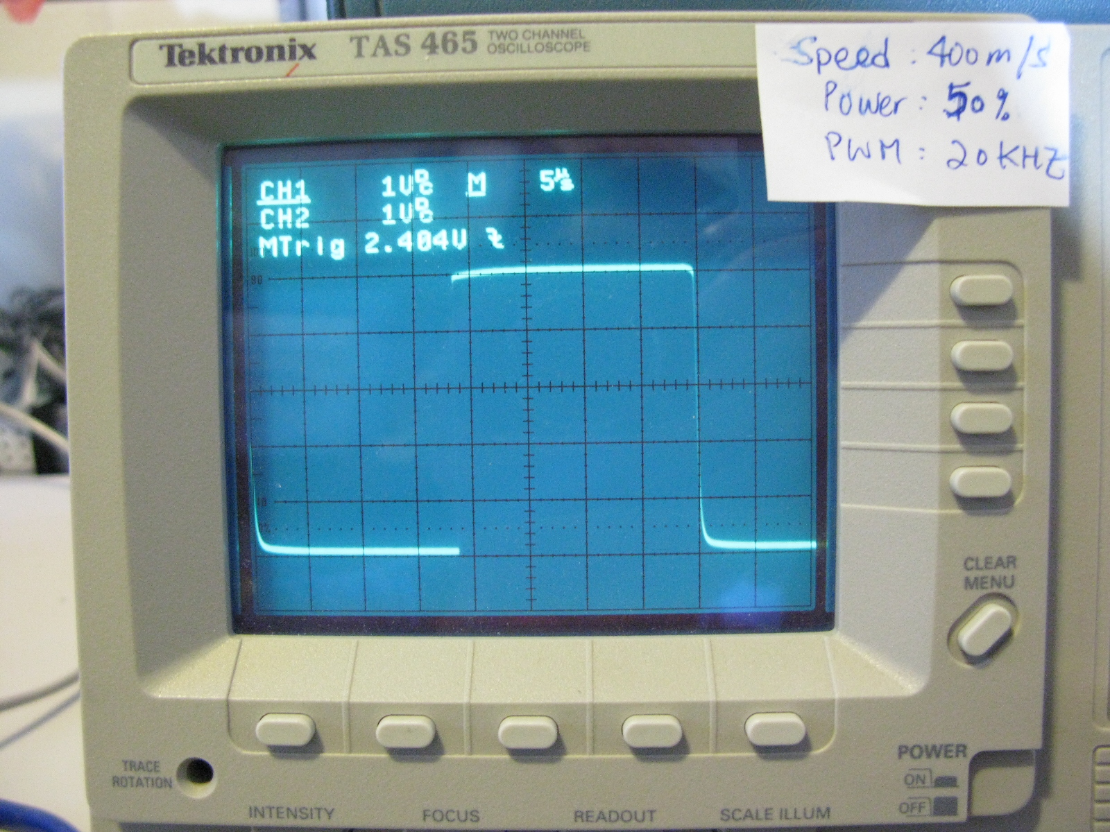

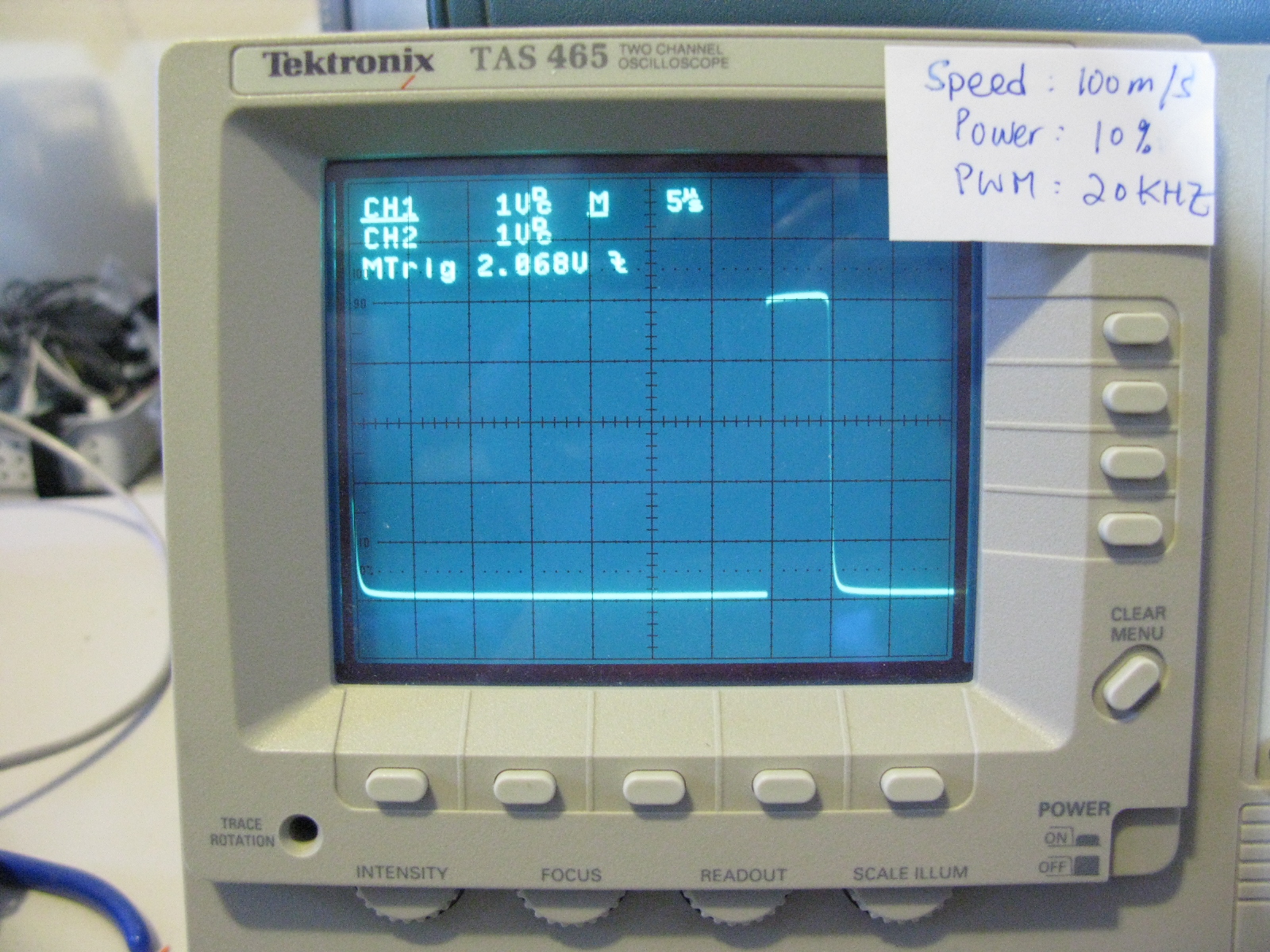

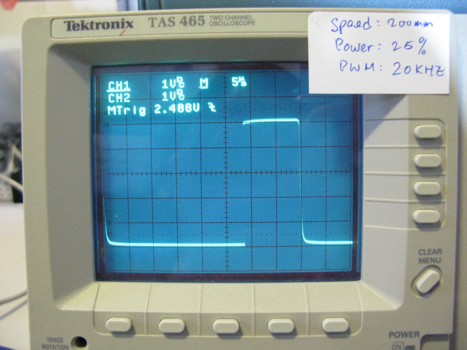

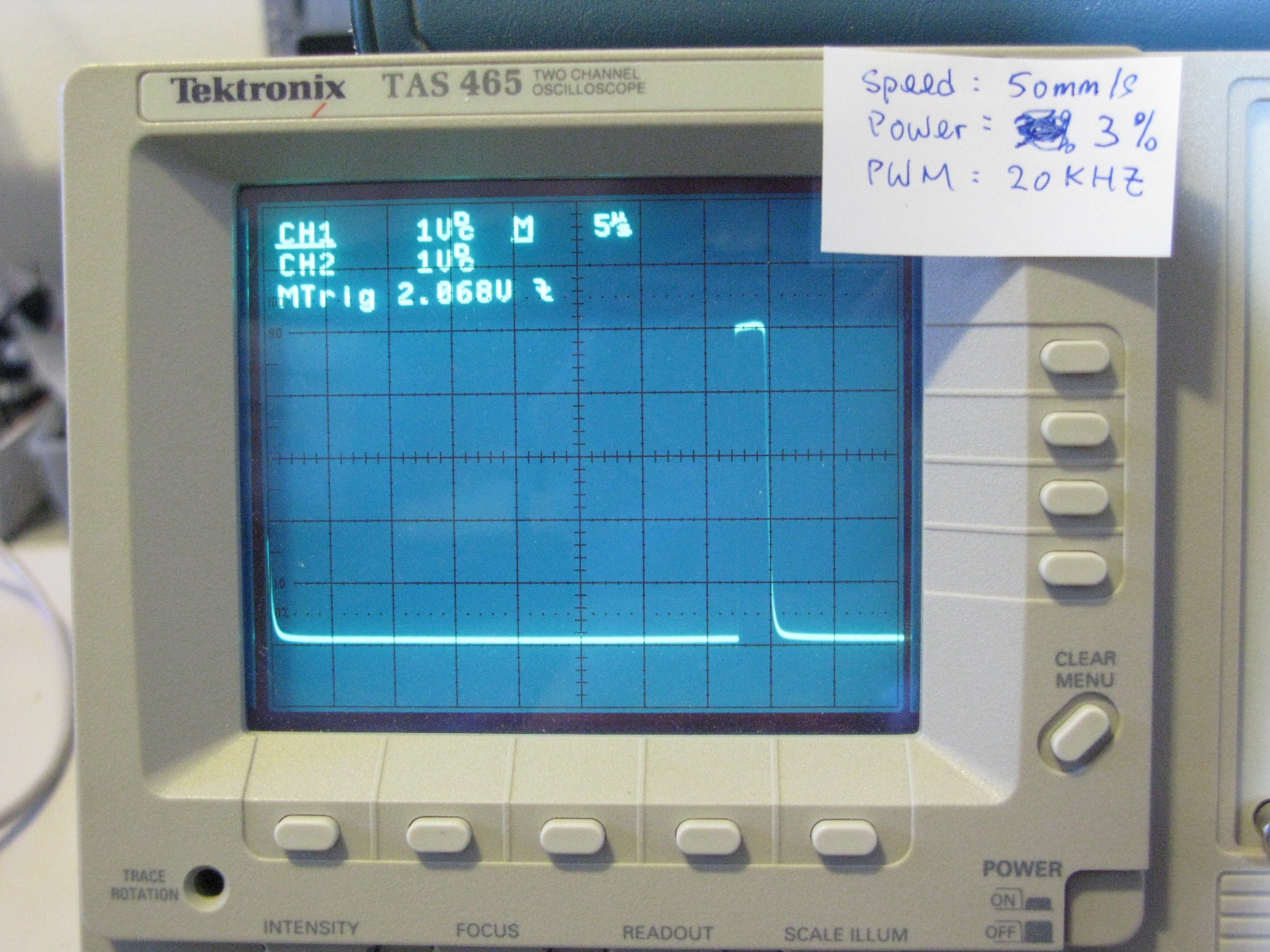

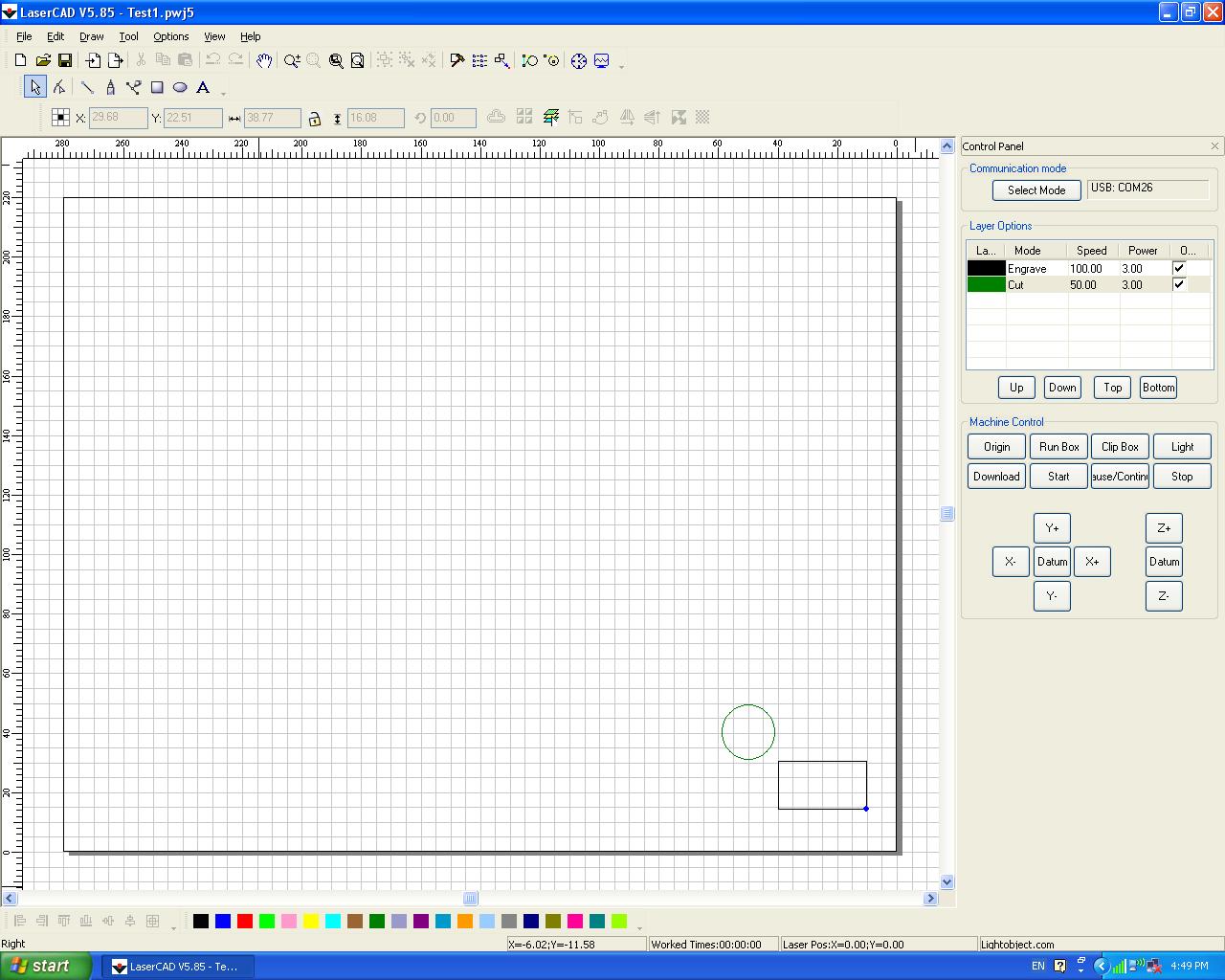

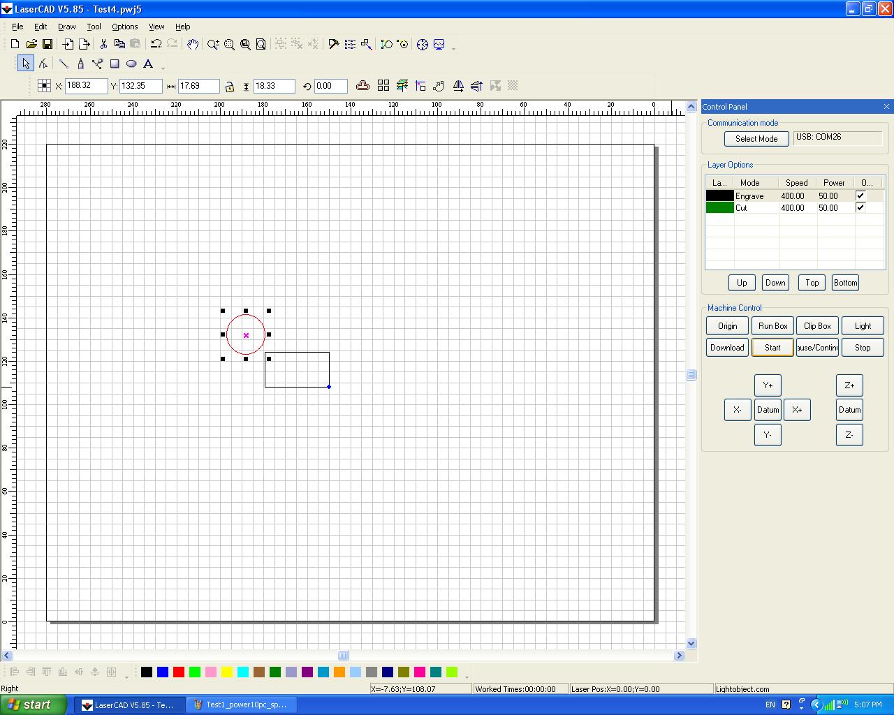

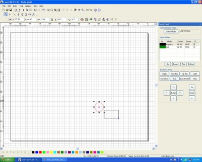

A customer keep complaining that the output current and speed from the DSP card wont change if read from a memory stick. So, I used my scope to catch output from sample files. It's a little hurry so I'm not going to explain it in detail, may be 3~4 days later when I come back from a camp.
Power
a) 3%
b) 10%
c) 25%
d) 50%

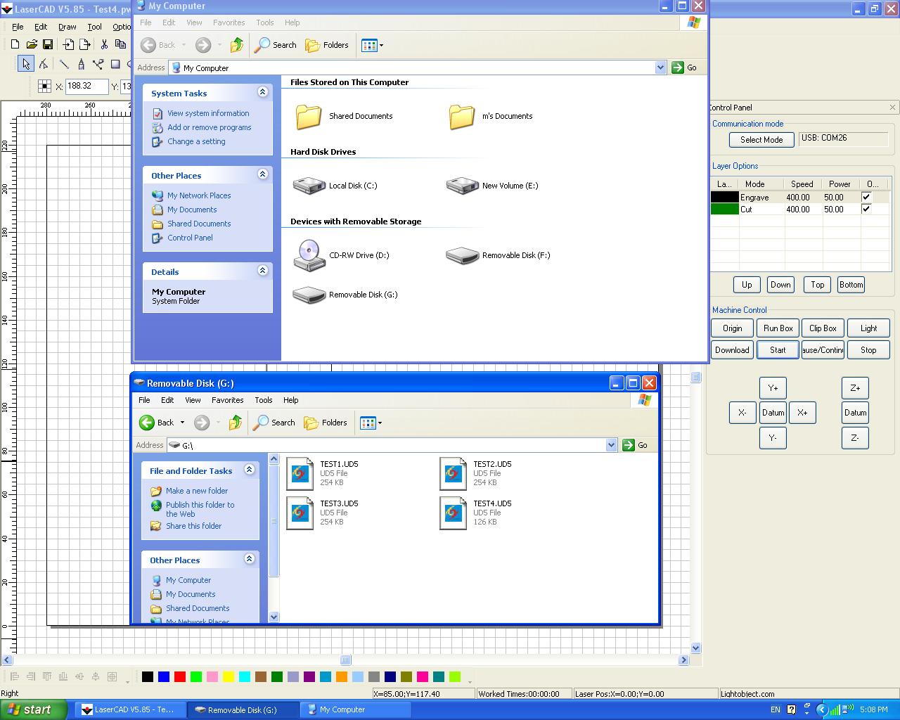

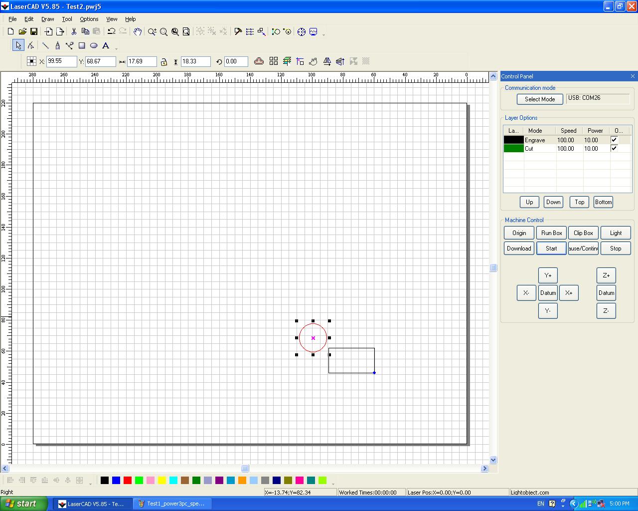

How I did the test?
