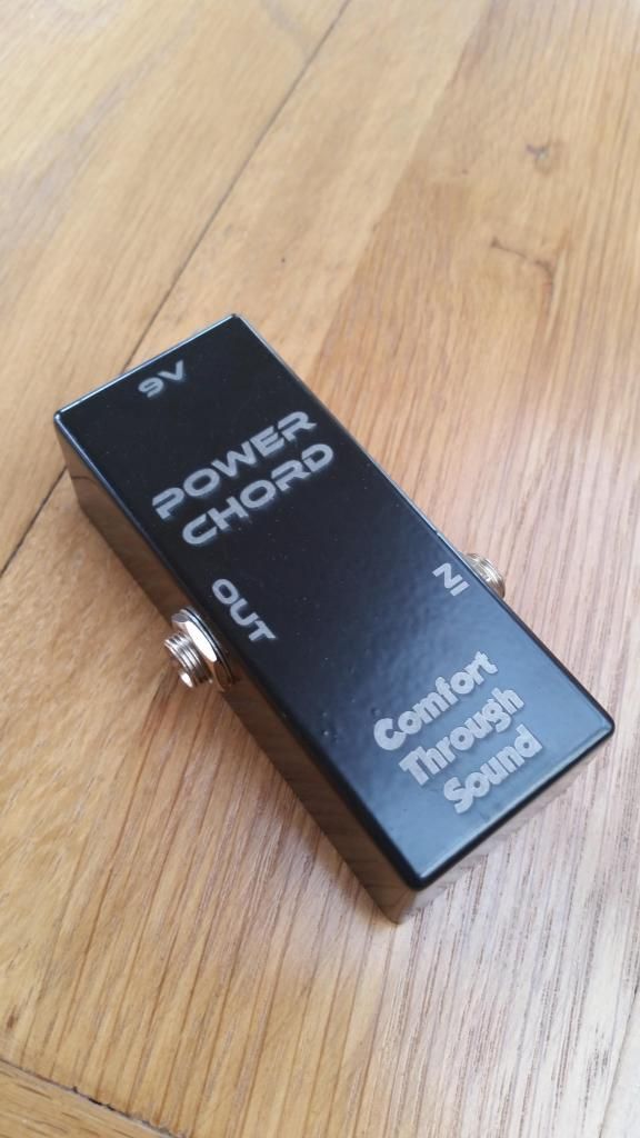

Also, I've got a slight issue with the engraving. When I've had some painted metal boxes done from a local place using their laser cutter, the lines appear between the letters and it's perfectly readable. However, on mine, the lines between the letters are non-existent, and the writing can't be read because of it. I've attached a photo of one that has been done by my local place, and you can clearly see the writing 'comfort through sound', but on mine it can't be read. I have noticed it does depend on which font is used, but I don't understand why the gaps between the letters aren't there.
I'm trying to play around with power and speed settings for the engraving, but without any luck, and any help would be greatly appreciated.
For the circles, they are a lot better now I've changed the 'falling edge' to 'rising edge', but till not great. If I lower the cutting speed from 100 to 50, it's a lot better, but there are 2 notches on the circle, directly opposite each other, no idea why though.

Strange, I can see the picture. I liked to it using the IMG tag from PhotoBucket. This link will hopefully work..... https://www.dropbox.com/s/9fio4cvq4uru7 ... 9.jpg?dl=0
I'll post a picture of what happens when I try the same font on my machine.
