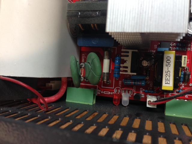

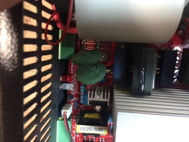

We have the 100w power supply purchased from light object. Today the laser stopped outputting power so I opened the supply to find cracked thermistors.
Is it possible to get new ones that I may solder and repair myself? Unfortunately we do not have a backup and will be down until this repair is made.

Just bypass it as it doesn't do anything.
Our new design has it eliminated.
