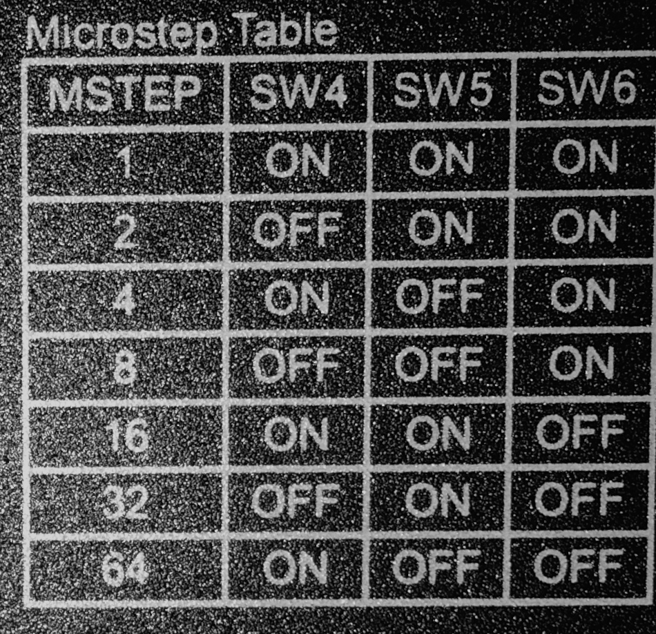

Thanks to Walt the innie-outie problem is solved ... only to reveal the next problem!
This is a K-40 with a complete DSP (Ligtobject's of course!) replacement control system, drawing done in CorelDRAW and fed to the machine via LaserCAD.
The x-axis keeps skipping anything from 1 to 3mm to the right, easily seen at the perimeter of this circle where it has happened several times (although the topmost 'skip' is - confusingly - to the left!). If this was on my 3D printer I'd say I was printing too fast but I'm not yet familiar enough with this system to know whether the same analysis applies.
Does it?
Nick

Re: Engraving - in and out
try to set the stepper driver to a lower setting. check your belt if it is a bit loose tighten ion the right site of the carriage

NickWL
- Posts: 252
Thanks Walt - by 'stepper driver to a lower setting' do you mean the current capacity of the hardware module? Or a setting within LaserCAD?
Nick
hi
no the stepper driver have dip switches where you select the um steps what is the name of the stepper driver??

NickWL
- Posts: 252
The stepper drivers are M415B from Lightobject, the relevant DIP switches and table are shown in the attached pictures.
The first 3 DIPs are set to give a current of 0.63A.
Nick
take it down to 8 and try
