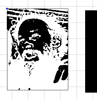

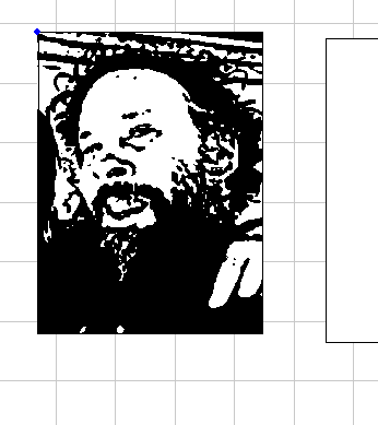

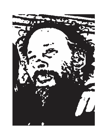

I am able to produce satisfactory rubber stamps and I am ignoring the grade engrave setting as I have not been able to get it to make any noticable difference.
Yesterday, though, again I had my drawing engraved oppposite of what was on the screen
this time, the image on the screen did not change, but the laser engraved the image inverted.
Here is a photo of the screen
https://lh3.googleusercontent.com/atug4 ... =s219-p-no
Here is how it engraved
https://lh6.googleusercontent.com/srCxi ... =s219-p-no
(hopefully you can all access the images)
In this case I was experimenting with my design but this means the system is unreliable and will almost certainly waste material in the future.
Marco, what advice do you have for me? I am becoming more concerned.

Here are larger images
and the resulting cut

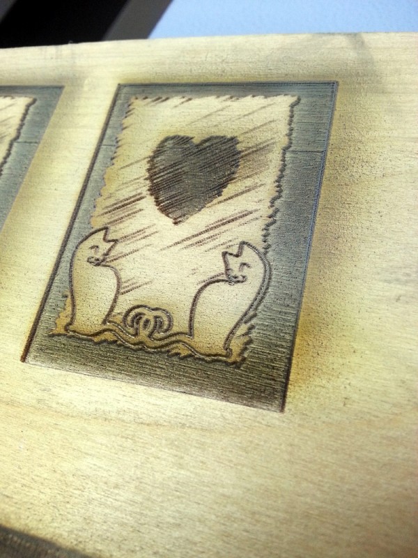

The problem was that you enabled the "GradeEngrave" on your power setting. If you disabled it, it will work fine.
See attached image I engraved on the of a piece of wood
Speed: 700mm/s
Power: 18% on 80W
Speed: 700mm/s
Power: 18% on 80W
