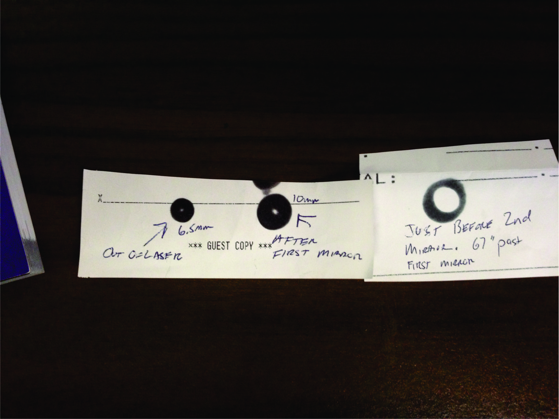

Marco... I have attached a picture with three different beam shots. The first is the beam directly out of the laser. Looks like 6.5mm. The second beam is through the 1.5x expander and directly after reflection off of the first mirror. The third is just before the second mirror at the other end of the table. The distance between the second and third beams is 67 inches. It looks like the tiny pin hole that you can see directly out of the laser is exponentially expanding. What do you think?? I'll try the laser pointer as well. Just don't have one here right now.

Posts: 4654
Re: 1.5x beam expander question
Chris:
You may want to find out the beam pattern without the beam expander. I'm suspecting that the tube you have may has higher divergence than usual.
What to do: measure the beam burn mark at the same location where you did with the beam expander. Check to see if the burn mark appear bigger at the second mirror when compare to the burn mark right in front of the laser tube.
I'm thinking that may be you should install the beam expander right before the 2nd mirror as you have very long traveling distance (67").

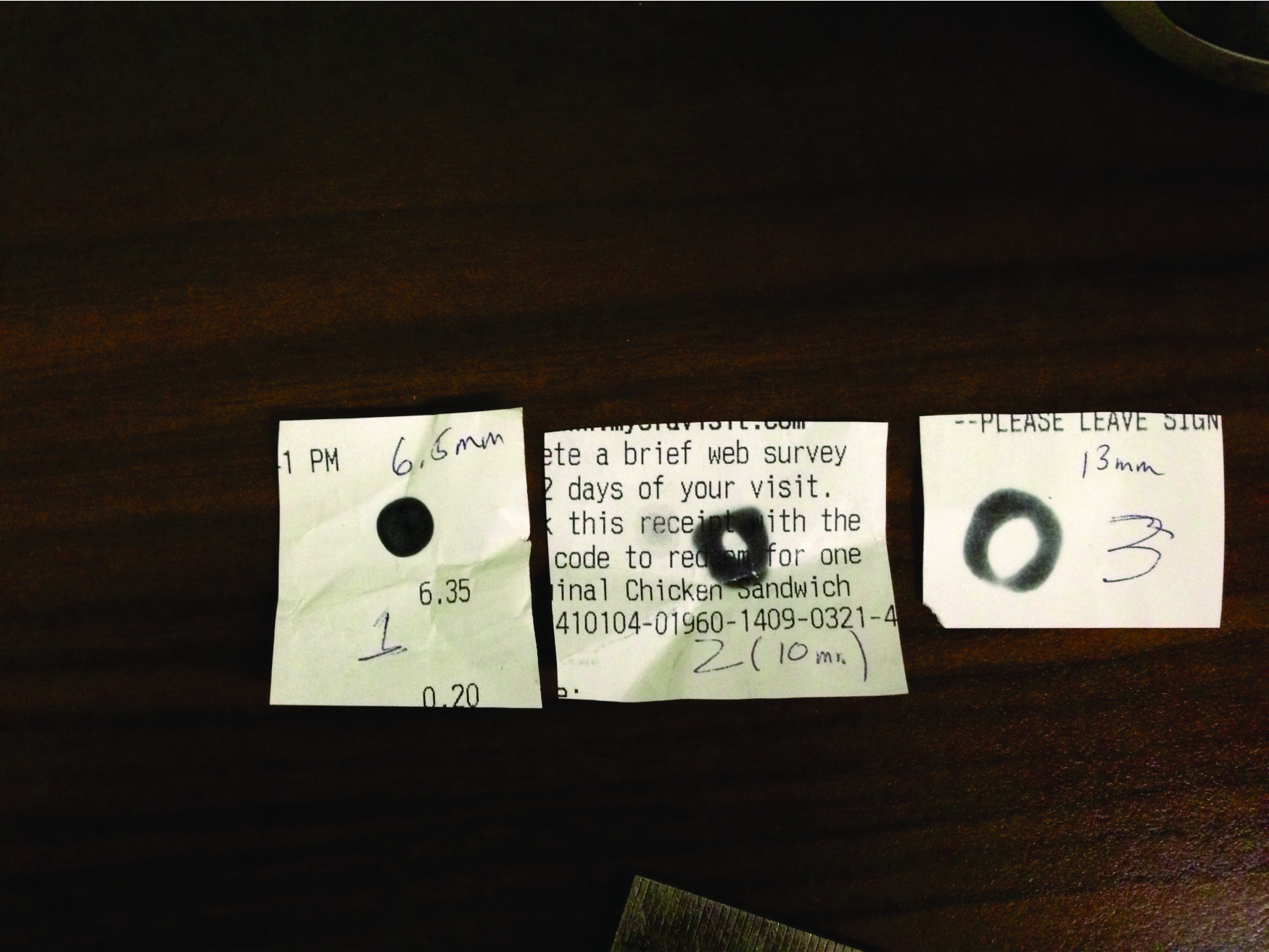

Thanks Marco... So here is the latest set of pictures without the beam expander installed. #1 is directly after the first mirror, probably 5" from the laser source. #2 is at the same position as the previous picture (67 inches from the #1). #3 is at the laser head at the farthest point on the table approximately 117 inches from the laser source. With the setup I have now WITHOUT the beam expander, I am able to cut 1/4" acrylic at 63% and 13mm/s. Is that about where it should be with a RECI 100w tube??

Posts: 4654
Chris:
I found that using paper as testing target was not easy to tell the beam diameter as paper burned very quick. I tried both paper and think cardboard (MDF kind). The difference was so obviously. I tried a Reci 100W and I got very good beam diameter from 1ft to 10ft distance. On paper, the burned mark could be as wide as 12mm from 10ft away. But if it is used on a cardboard, the mark was merely 8.0~9.0mm.
I took some pictures and I'll post it here later. I found a funny issue: the bigger beam diameter happened at 5~6ft distance than getting smaller. I think some beam power first diverse out once it pass certain distance, it was getting weaker. But that my assumption only
I may do more tests by applying water on the paper and the MDF, that way the burn won't get diffuse out. That should give me better way to find the beam diameter.
