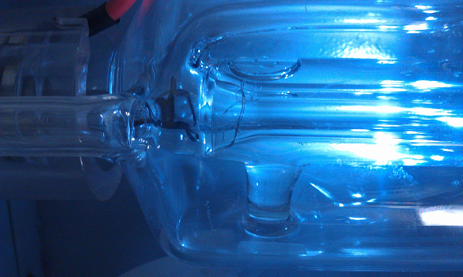

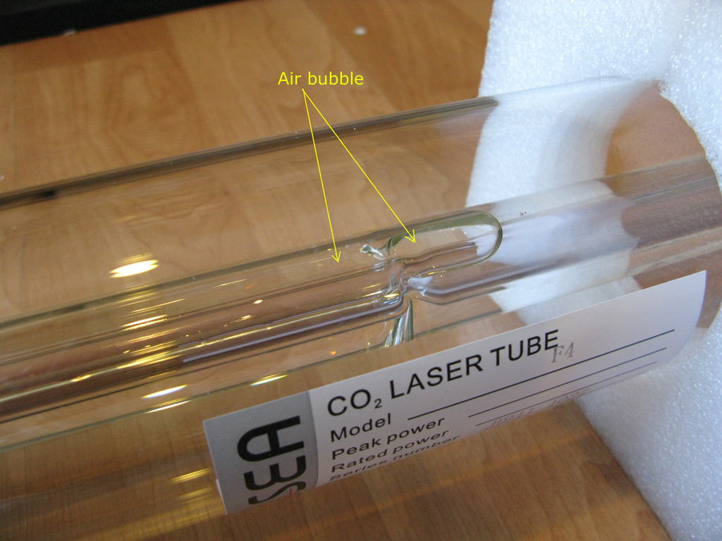

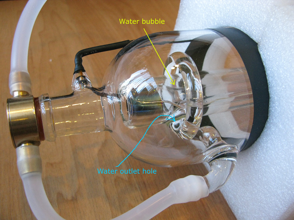

I was thinking "Shoot, do I need bigger pump like 15L or 18L?". Then I observed something a little odd. I saw that the tube was not in horizon but with about 10 degree slop down to the water-out side. Hmm..... that could lead to the problem I guess. So, I raised up the other end of the tube and allow about a little up-slop. Now. it seems working and I saw rapidly water flow movement happened right at the moment I raised up the tube. But there is one more issue. There were a few big bubble couldn't escape from the tube. I turned the tube in two direction and in a sudden, all bubbles sucked out so quick! Bingo! Now I saw what's happening. The outlet tubing (glass hole) must be on the top of the laser tube or bubble couldn't escape from the tube. Little thing but extremely important! If there is a big bubble exist to the two pole; anode and the cathode, the chance of having cracking tube or damage pole is very significant.
So, when you setup a laser tube, do three things before close the cover:
1) make sure the tube is level or with 2~3 degree up
2) make sure the outlet hole is on top of the tube but not facing sideways or downward
3) test the pump and make sure no water bubble (I mean the big one) stuck inside of the tube
