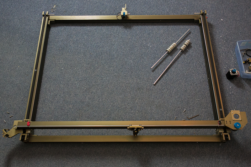

My parts showed up on Friday and I've just started to assemble the X-Y stage. Hopefully I'll have the electronics tested out tomorrow night. Build quality is great and It's very easy to put together. The work area is huge, It's hard to imagine how big something this size is until you put it together. I almost went with the XLE 1200*1800 X-Y Stage but I don't think I'd have had enough room by the time I managed to build a case around it.
I'll post some more photos once I have the electronics installed. Then I just have to wait on the extrusion to mount the 80 watt tube.

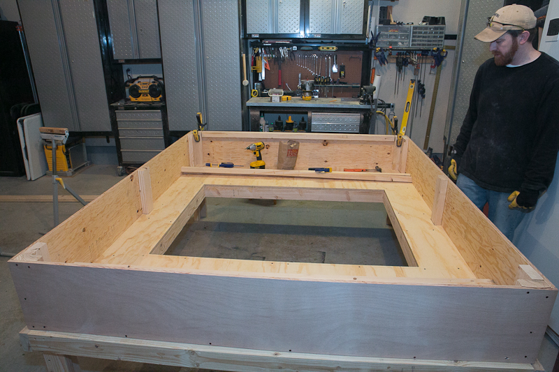

Started building the box for the XLE 900*1200. I'm not very good at welding so a wood case seemed like an easier option. With the master help of my friend Chris I was able to get this far in the frame build. If all goes well we should have the frame completed and the laser mounted by the end of the weekend.
I'll post some more pictures and the project progresses.
