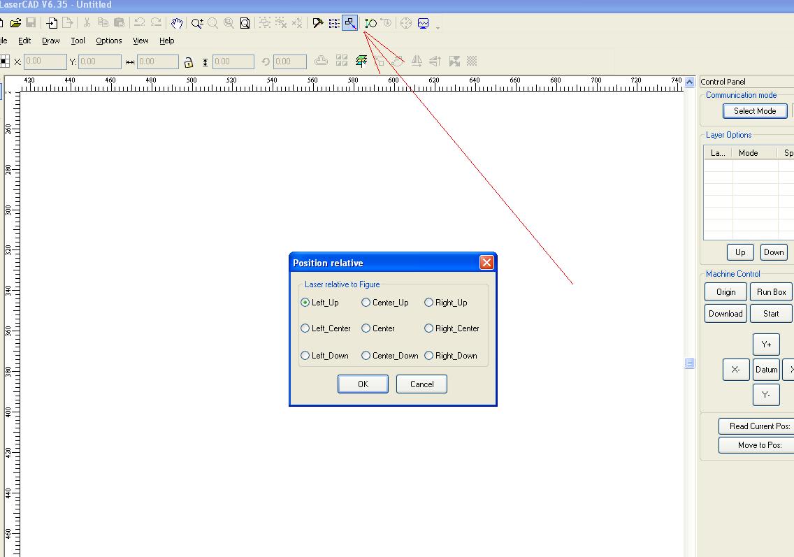

Re: Engrave beyond size
You need to check the setting of "Relative position". If you don't do it setup properly, you will always get "Beyond size.." error
Make sure the Relative Position match the Home Switch as many folks always having this trouble. It's not just the acceration or speed issue. It is this: relative position
I didn't see your setting on "Position Relative"
If your limit switches (Home) are installed at Top-Left, then you better set the positive relative to "Top-left" also called "Left-Top"
Important note: Once you have changed the mode, you need to hit "Reset" button on the LCD unit to refresh the change. Otherwise, it won't take any effect for the new change you made!
