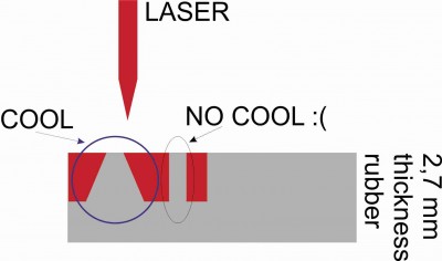

What were you trying to say? I don't know understand the picture mean, can you explain it?
bystrobi
Posts: 4
Joined: Sat Nov 10, 2012 2:46 am
Re: CHINA product Laser CO2 40W 3020
Post by bystrobi »

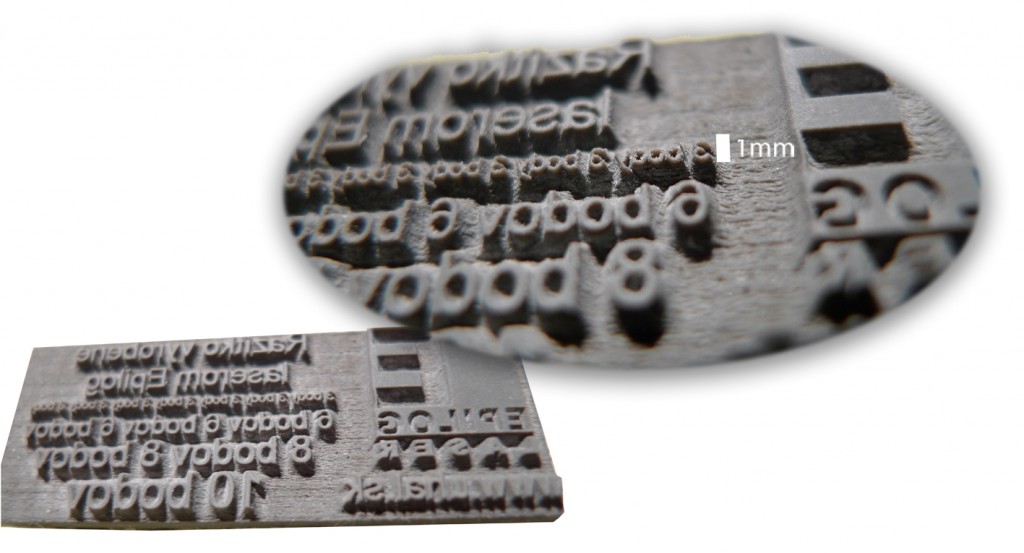

This is a rubber stamp. There's displayed height rubber which is about 2.7 mm.
Is marked with red laser scope. Gray is marked rubber. Laser machine that I have only one power carves.
But I need to do that as a lot of the picture "COOL". Stamp on the letter needed basis to bending.
Now it solved so that extra edge on the letters, it is about and after the third cascade lasing occurs hill. But it is very difficult
the graphics and the overall time.

Picture ruber stamp
