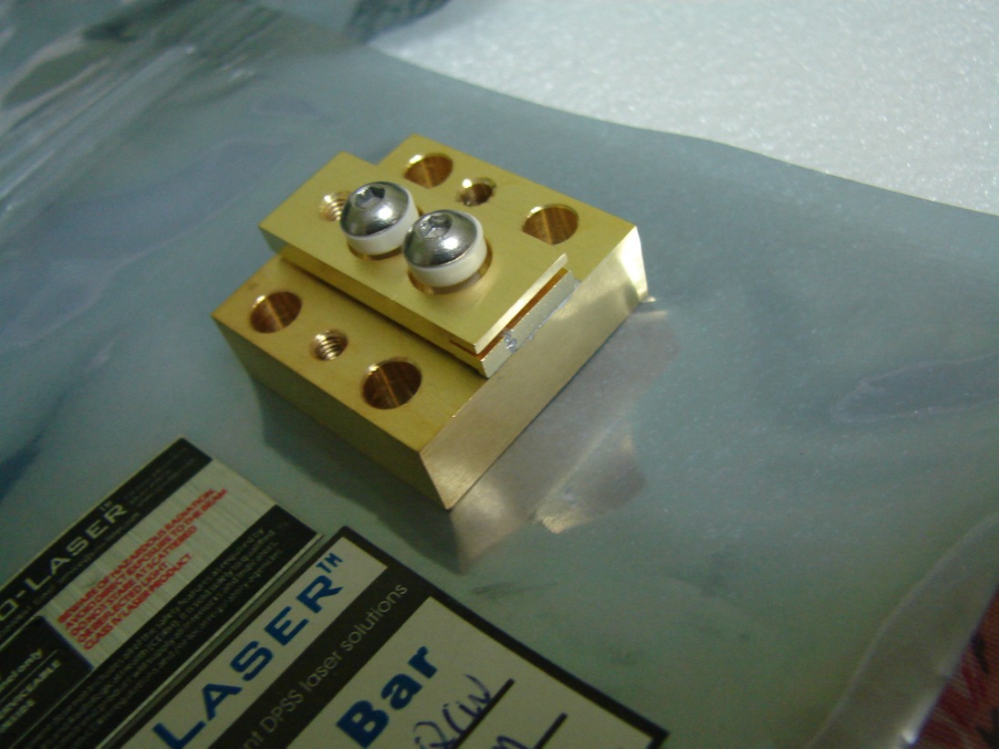

I have this question, maybe a dumb question but I decided to ask since I don't know much about them. Do you know if some one has used a laser diode in a engraver cutter machine? if so, what would be the pros and cons? also I have read that YAG lasers are mostly used for medical equipment and a few marking devices. Obviously CO2 laser tubes are the most popular for etching ,engraving and cutting for most common materials but I would like to know what you know about the diodes and if it would be worth experimenting with them. Thank you!
