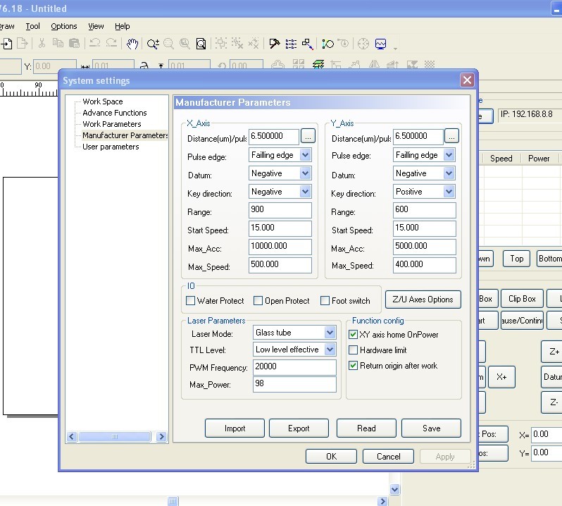

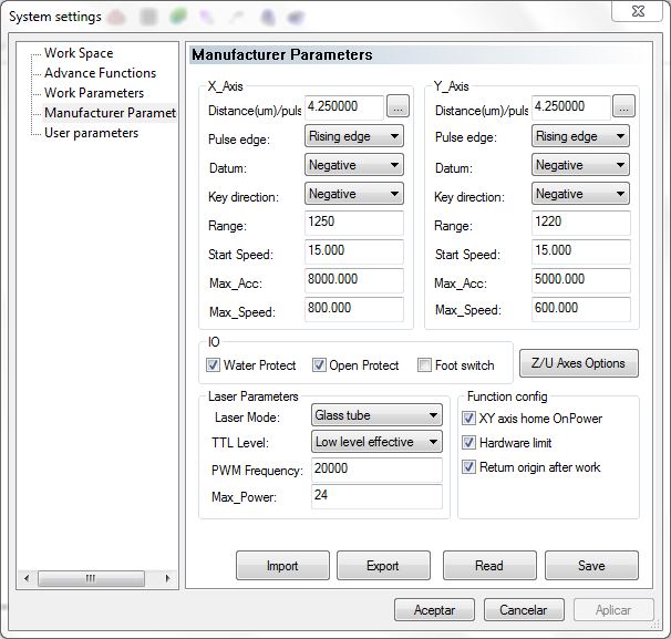

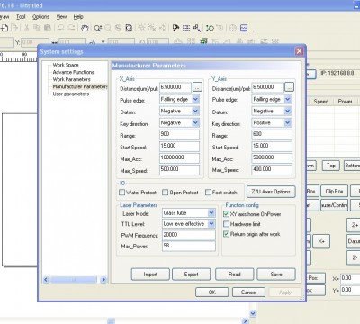

Post by fnaranjob »
I have the manufacturer parameters exactly the same as they were before the upgrade, note that the problem only happens on engraving, if I do vector cutting speed and acceleration are normal, here are the settings I'm using:
Manufacturer parameters
Posts: 4654
Re: Problem with last OS upgrade, insane engrave acceleratio
Can you also send "User Parameters" and the file you have trouble with (.pwj5)

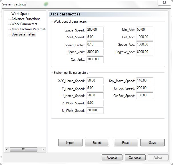

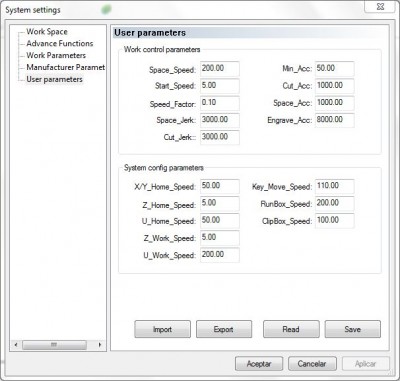

Post by fnaranjob »
This is the user parameters, I even reduced cut jerk and speed jerk a lot but the problem persists, I had to load an older OS version, Please make some engraving tests, thank you!
