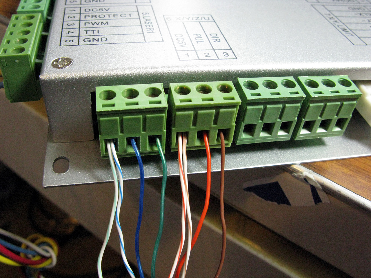

Connecting DSP with 2M415
Attached pictures are showing the connection of 2M415 stepping motor to a DSP controller.
Pay attention to the color of wires, especailly the Blue/White for the power. Don't be confused with the power. I should use Red/Black but I didn't have wires handy so I used the Cat-5 cable
The connection is pretty straight forward: PUL to PUL and DIR to DIR
The confuse part is hte "OPTO". Just connect it to the +5V from the DSP main board will take care it
