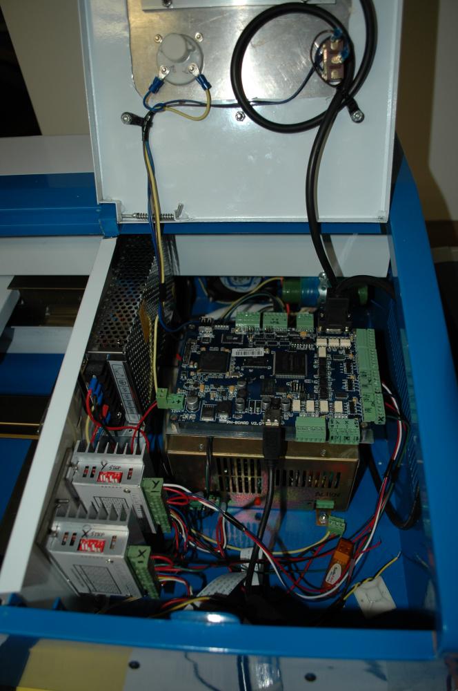

I got the DSP board installed, homing is good now, arrow keys all work, I owe you for shipping. I installed 2 mechanical limit switches. I had to replace the Laser tube, and attempted to align the optical path today but discovered that whenever the machine is energized, the laser fires immediately at 10 MA and cannot be controlled. When the LP-1 connector is unplugged the laser woint fire unless the small red Test pushbuttoin is pressed on PS.
My PS is enclosed version in a gold colored case. all others I've seen are open frame type, I wanted ot see if there were any changes in DSP LP-1 terminal voltage status with Laser keypress, but didn't see any changes with a DVM. Some terminals were 2.8 to 3 volts but none of them changed states. It might be a short event. I was going to drag out the scope but thought I'd wirte first. I saw the youtube video you made.so I'm confident the board is OK. I am attaching some pictures of limint switches and the power supply that came with this machine.
I tried to upload the pictures but it failed.

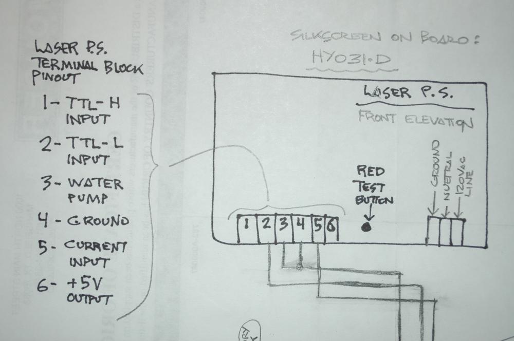

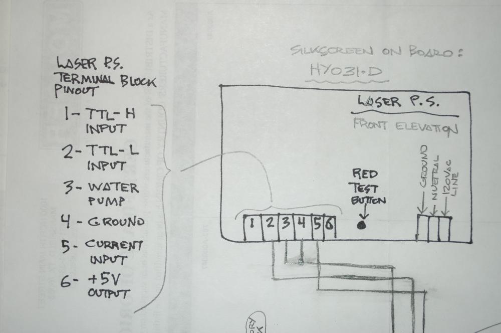

Here's the wiring connections:
DSP Laser 1 terminal block Laser PS terminal block
1 -------------------------------------------------- 3 and 4 3 is water pump, 4 is ground
2
3 -------------------------------------------------- 2 2 is TTL-L input
4 -------------------------------------------------- 5 5 is control input
5
6
Ground is connected to 24 volt negative switching PS, and equipment/case ground, which up here means earth ground/water pipe.potential.
Maybe I should just change out the laser PS and be done with it. I don't know what to get.
Do you think this PS caused damage to the DSP?
cheers,
Denis

I will draw a picture of the wiring connections between DSP and PS and send the picture.
I've enclosed several pictures of the PS and the 50 watt wirewound resistor has been relocated on to the rear panel in the fan airstream # 4959, # 4963
Several PS pictures are # 4962, 4961, 4964
Wiriing diagram between DSP and PS is # 4966, 4967, 4968.

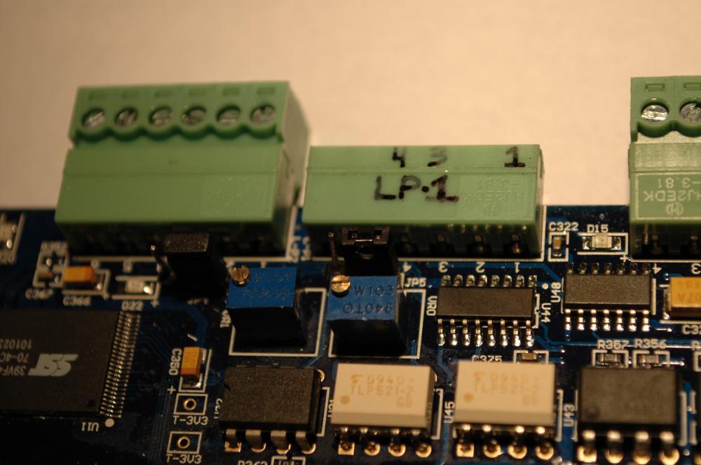

I'm pretty sure that your PS is PWM mode. So, you must change the output signal from Analog to PWM on the card. It's easy, just move the jumper from #1,#2, to #2,#3. You should find two jumper J4 and J5 right below the Laser1 and Laser2 phoenix terminals. I thoughs your PS was analog so I set it to #1 and #2.
If you can't locat the jumpers, download the a pdf from this post: viewtopic.php?f=16&t=746
After the change, try again.

yes, I had already moved the jumper from 1-2 positon to 2-3 position earlier this week, I think you emailed me about changing it to 2-3 position on August 14, but the condition remains unchanged.
I changed both jumpers J4 and J5 to 2-3 position.

- Posts: 4655
Denis:
Do the following:
1) Twist the the small blue potentialmeter (VR) under the the Laser1 counter-clockwise see if it can stop the fire. The VR supposed to be used to control output current for analog. But I'm not if it will does same thing on PWM. I tuned it almost 90~95% on your card
2) If the #1 doesn't work, try switch TL<>TL to TH <>TH between the DSP card and the power supply. What it does is to switch from level low to level high triggering.
3) Check the configuration on the PHCad to make sure the change. I believe that there is a place you can do level low or level triggering but not sure if that is related for the laser fire control
4) Make sure you're seletcting CO2 tube rather than RF tube on the manufacturere setting.
Let me know how it goes

I got the laser PS going OK today, I followed suggestion by Bart Ding of buildlog.net and he gave directions to a schematic.
here's the link to the schematic I followed:
http://www.buildlog.net/wiki/doku.php?i ... nal_blocks
scroll down to below the heading Connectors/Termnial Blocks
I was short 1 wire, the schematic I had was wrong for me. The page heading read:
4. Power supply connection
Now I got to align the optical path and figure out how to use the software, but that's a job for tomorrow, and here's how someone did it with pictures:

- Posts: 4655
I don't see any problem of your connection diagram above. It looks good to me. Which wire was shorted? Are you now using #2 (TH) to enable the Power supply? If so, it means that the either the PS's TL or the DSP TL (level low) has an issue
Anyway, the hardest part has past and the alignment adjustment is considered much easier than anything else.
